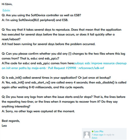

Hello Leo,
Leo Mo said:You can check my previous answers.
Did you say that you already included this PR? I am not sure I can see it. Can you point me to it?
Note that NCS v3.3.0 does not include this pull request.
Let us assume you recently ported your application to v3.3.0. Did you use the unmodified esb_tx_ble and esb_rx_ble to reproduce this issue? And you did includde PR 29998? Did you do anything else to your NCS SDK? Or is everything else left as is, so that if I built your application, I could reproduce what you are seeing using 2x nRF52840 DKs? If so, what should I look for? Does the log state when the issue occurs?
Edvin
Hi
Yes, my code already includes this PR(subsys: esb: improve resource cleanup on init error paths by maje-emb · Pull Request #29998 · nrfconnect/sdk-nrf). You can check my previous replies, which include error logs and nRF52840DK code.
Leo

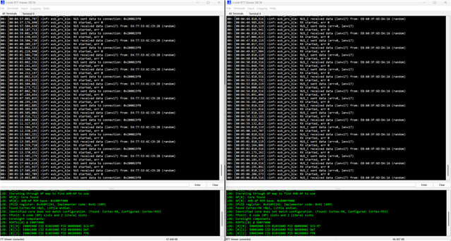

Hi Edvin,
Sorry, Using these codes(esb_prx_ble_central_peripheral.zip, nRF Connect SDK v3.3.0/v3.4.0) will make it easier to trigger this issue.
1. prj.conf for Peripheral(nRF52840DK).
2. prj_central.conf for Cnetral(nRF52840DK).
3. Place two 52840DKs together, ensuring RSSI >= -40. Central will scan the Peripheral and connect.
4. After a successful connection, the two devices will send data to each other through the NUS service and open the ESB (esb_start_rx).
5. Using J-Link RTT View to view the logs, it may take several hours for this issue to occur. The logs are as follows:
[06:01:52.518,341] <err> esb: gppi_channel_alloc failed with: -12 [06:01:52.518,371] <err> esb: Failed to initialize PPI
