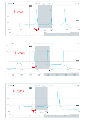

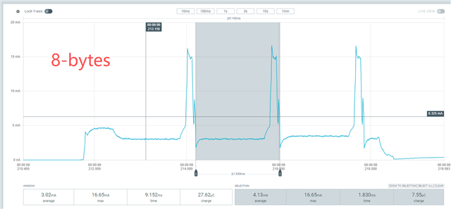

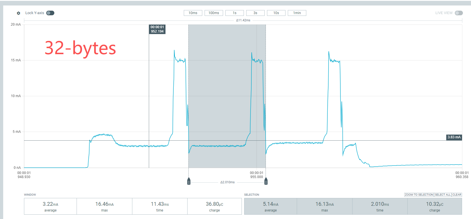

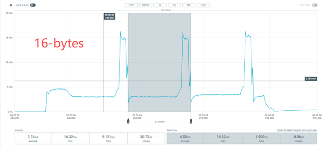

    Another question is why sending 8 bytes, 16 bytes, and 32 bytes takes about the same amount of time? Is it time-consuming to prepare before sending?
    config ESB_MPSL_TIMESLOT
        bool "ESB on MPSL Timeslot [EXPERIMENTAL]"
        select EXPERIMENTAL
        depends on MPSL
        depends on !ESB_NEVER_DISABLE_TX
        depends on !SOC_SERIES_NRF53
        help
          This option configures the ESB to use the MPSL Timeslot API as middleman in radio access.
          It allows multiple protocols to be used concurrently. Using the Timeslot API can increase
          number of retransmissions, reduce ESB packets delivery rate, and cause the delay of
          retransmissions to vary.
    config ESB_NEVER_DISABLE_TX
        select EXPERIMENTAL
        bool "Never disable radio transmission stage"
        help
          This option changes the radio behavior so that the
          transmitter remains IDLE between transmissions instead of being disabled.
          This is applicable only when the packet is not acknowledged. Otherwise,
          the radio emitter needs to be turned off to enable the radio receiver.
          This reduces delay between consecutive transmissions but consumes more energy.
    ESB_MPSL_TIMESLOT and ESB_NEVER_DISABLE_TX cannot be set to y at the same time.
    Is there any way to reduce the preparation time before launch.
    while (1) {
    	    err = esb_initialize();
    	    if (err) {
    		    LOG_ERR("ESB initialization failed, err %d", err);
    		    return 0;
            tx_payload.length = 32;
            for (int i = 0; i < 3; i++) {
                   tx_count += !esb_write_payload(&tx_payload);
            while (!esb_is_idle());
            k_sleep(K_MSEC(100));
            esb_disable();
            seq_num++;
            tx_payload.data[6] = seq_num & 0xFF;
            tx_payload.data[5] = (seq_num >> 8) & 0x7F;
            tx_count = 0;
            k_sleep(K_MSEC(1000));
  • Hi Leo,
    There is a payload discrepancy, it is just very small.
    Looking at your snippet, this stems from your code snippet mainly. As you can see in the image, the period where you do TX differs from the 3 images, but the sleep time in between each operation is so large compared to the Tx window that it is hard to notice. Measure this window instead of the pause to see the actual difference of the TX time.
    Roughly summarized what each cycle is
    1. A rise to a ~3 to 4 mA plateau that sits there for a while.
    2. Two short spikes up to ~16 mA (the actual radio TX).
    3. Back down to near zero.
    The payload is the only part of the transaction that scales with size.
    • On-air payload at 2 Mbit/s: 8 B ≈ 32 µs, 16 B ≈ 64 µs, 32 B ≈ 128 µs. Which is very small in the almost 2ms timescale of the selection view
    • Fixed per-packet cost that doesn't change with size: TX ramp-up (~40 µs fast, ~130 µs legacy), preamble + address + PCF + CRC (~35 to 45 µs on air), and with ACK enabled the turnaround to RX to catch the ack.
    The time between the packs you queue up is governed by esb_config.retransmit_delay, not by payload length. In the NCS samples that is typically ~600 µs. Three packets at that spacing is your largest contributor to on-air time, and it's identical whether each is 8 or 32 bytes.
    Is this test set up to do initialization every time before each pack? If this is not a test case, then the following might improve the time used for preparation in between each burst.
    • Move esb_initialize() out of the loop. Re-initializing every iteration reconfigures the radio and can force an HFCLK cold start. The initialization is the plateau you see in between each TX
    • Don't esb_disable() between bursts unless you need the radio released, since disabling can drop HFCLK and you re-pay the crystal ramp next time.
    Andreas
