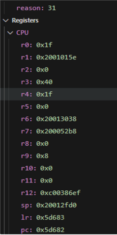

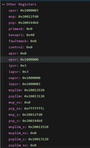

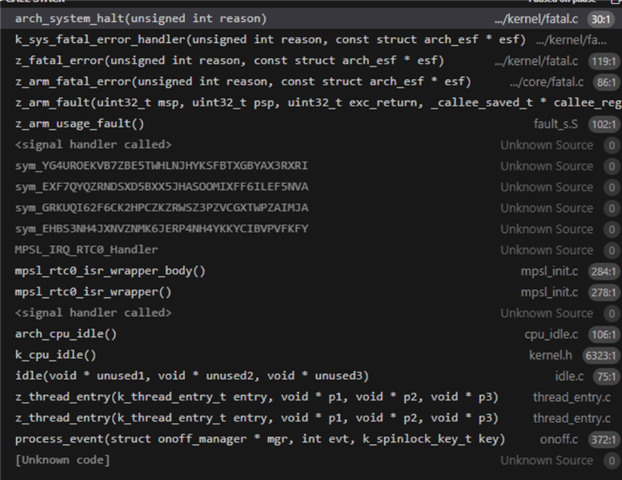

  • HI
         Sorry for replying to you only now. The reason is that this issue is difficult to reproduce, so it took a long time. During this period, I obtained two phenomena.
        The first phenomenon is that the above logs have not been added yet, but the watchdog has been turned off in order to be able to use VS code to view the scene. However, this time there were no error logs when the problem occurred. Then I connected the board to another computer's jlink  and used the "Attach Debugger to Tager" function of VS code. I saw the following situation, but I cannot analyze it and am not sure if this method of capturing logs is reliable
    JLinkGDBServerCL: =thread-group-added,id="i1" =cmd-param-changed,param="pagination",value="off" arch_system_halt (reason=reason@entry=31) at E:/ncs/v3.1.0/zephyr/kernel/fatal.c:30 30 for (;;) { Program received signal SIGTRAP, Trace/breakpoint trap. arch_system_halt (reason=reason@entry=31) at E:/ncs/v3.1.0/zephyr/kernel/fatal.c:30 30 for (;;) {
        The second phenomenon is that the above log was added to the main, but the watchdog was still turned off, but the device still restarted without any error logs. However, I saw that the reason for the restart was Reset from CPU lockout detected.
        Can you help me explain the above phenomenon, or do you have any suggestions? I have no direction left.
