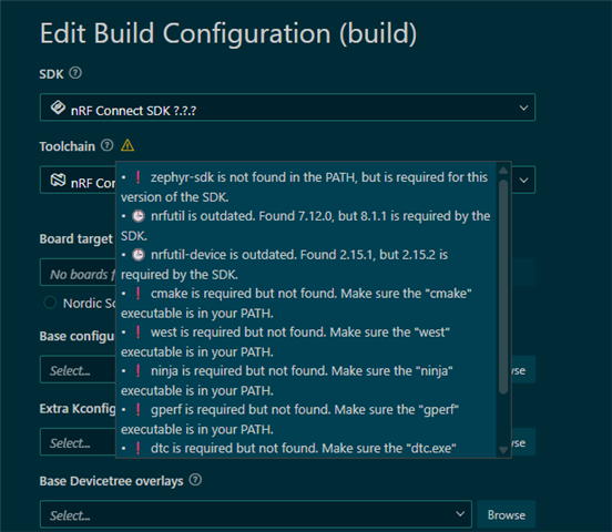

I'm having an issue where VS Code cannot recognize the SDK and toolchain. Everything was working fine before, but now errors occur when I open VS Code and try to build the project directly, as shown in the picture. How can I fix this?

  • Try downgrading the nrf connect extension to 2026.1.1327 version.
    Note that ZEPYHR_BASE sounds like a terrible idea when using vs code plugin - it should be handled internally AFAIK and point to the selected NCS SDK for a project when compiling/running tools.
  • I have manually added the following paths to the system environment variables:
    • D:\ncs\toolchain\toolchains\66cdf9b75e\opt\bin
    • D:\ncs\toolchain\toolchains\66cdf9b75e\opt\zephyr-sdk\arm-zephyr-eabi\bin
    • ZEPHYR_BASE = D:\ncs\toolchain\v3.2.1\zephyr
    Now the build can pass successfully.
