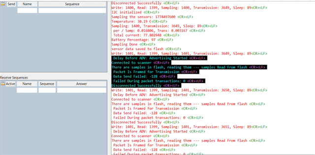

nRF52833: MTU Exchange Fails and Connection Terminates
Hello Team,
     I am working with nRF52833 configured as a BLE scanner using nRF Connect SDK for VS Code.
Here is my prj.conf:

AND here is scan/conn Implementaion:
static void discovery_work_handler(struct k_work *work);
static void scan_filter_match(struct bt_scan_device_info *device_info,
    struct bt_scan_filter_match *filter_match,
    bool connectable) {
    bt_addr_le_to_str(device_info->recv_info->addr, addr, sizeof(addr));
   LOG_INF("Filters matched. Address: %s connectable: %d RSSI: %d",addr, connectable, device_info->recv_info->rssi);

Issue Observed:
  • Occasionally, the full data log is received successfully
  • However, most of the time, device disconnecting as:
    • MTU exchange fails, Error 0x3E (Connection Failed to be Established / Timeout)
    • MTU exchnage and sunscription succ, Error 0x13 (Remote User Terminated Connection)
  • RTT logs (showing both successful and failing cases)

While debugging the peripheral-side logs s, I am observing an error code: - 128
  Could you please help identify the possible root cause of:
  • MTU exchange failure
  • Unexpected BLE disconnections
  • And whether the peripheral error -128 could be related to this issue
  Also, please suggest any configuration or implementation changes required to stabilize the connection.
