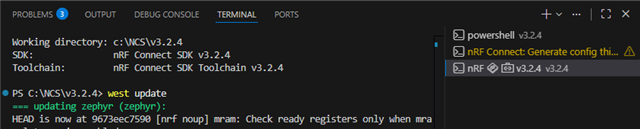

  • Hi Paul,
    Try opening the terminal via Manage Toolchains in the WELCOME frame, then execute "west update".
    You can refer to https://github.com/NordicDeveloperAcademy/cell-fund/tree/main/l2/l2_e2_sol
    Amanda H.
  • That seemed to help: it eliminated the errors in the l2_e2 main.c. However, it did not fix everything. I still am getting the following:

    Also, in the interim I have discovered that despite all of the reported items in the PROBLEMS tab, the build actually completes and I can flash it and it seems to work. Appears to perhaps be a vs code extension or build/reporting issue? All I know is that I should see zero warnings, zero errors on builds-- especially examples and tutorial builds. Right?  Thanks for the quick reply and the helpful suggestion! 7 down, 6 to go!
  • If you don't get any build errors and it can work as expected, you can ignore them.
