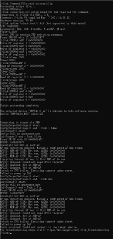

    I understand your confusion, and what you said is correct, debug access is denied when APPROTECT is enabled. However, you can still access the device via CTRL-AP. Please refer to the script I shared in my first response. It is a J-Link script, so you need to use J-Link Commander here, not nrfutil.

  • Hello Abhijith,
    Thank you so much for your help! This information is really helpful and solved my problem perfectly.
