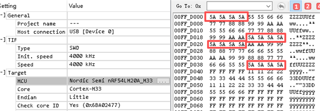

  • Dear NORDIC engineers, excuse me. I would like to inquire about the Settings of NRF54LM20 APPPROTECT. I have modified APPROTECT[n].protect0 and APPROTECT[n].protect1 to 0x5A5A5A5A. SECUREAPPROTECT[n].PROTECT0 and SECUREAPPROTECT[n].PROTECT1 have also been modified to 0x5A5A5A5A. However, after re-powering, the chip can still be connected and the FLASH can be read. The software used is J-Flash 9.30a. According to the manual instructions and my development experience with the NRF54L15, these registers should enable Access Port protection once they are set to values other than 0xFFFFFFFF.
