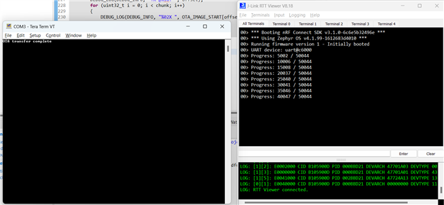

The transfer starts correctly, but it consistently stalls before completion. For example, in a 50,044-byte transfer, the logs show it hanging at exactly 39,931 bytes. Attached the config files and log screenshot for reference.

    • Issue: The transfer consistently reaches approximately 48,160 bytes, at which point the nRF54L15 performs a hardware reset (I see the bootloader banner again).
