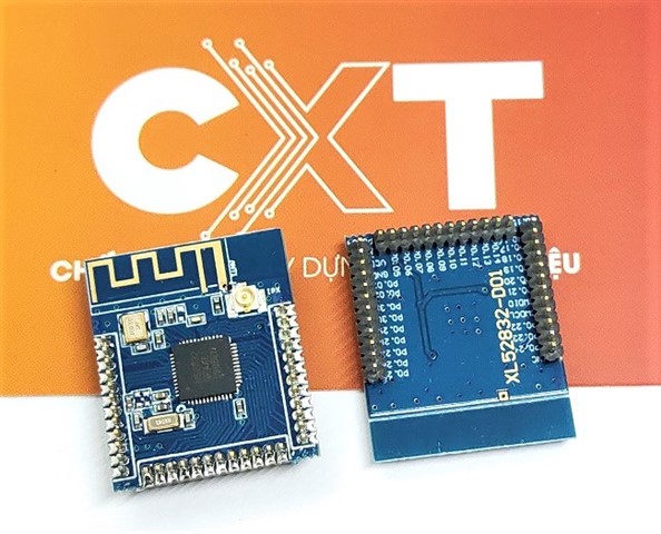

At the point of posting this, the only solution I haven't explored is adding decoupling capacitors which my current module might not have. I've attached an image of the type of module that I'm currently working with.

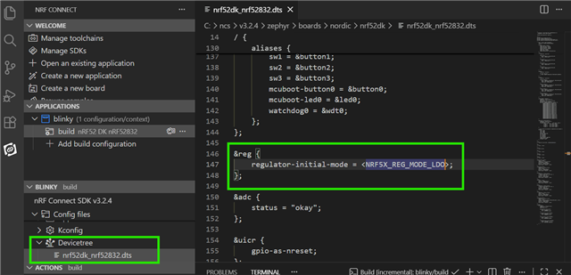

    I finally managed to get a working solution, as far as I've tested. You are quite correct in your response in changing the regulator mode from DC/DC to LDO, a step which I thought I had completed by implementing it in the board overlay. I will try and link some of the sources that helped. As seen in Picture 1, I created a board overlay specific to my current hardware, cleaned and rebuilt but still got the same bahaviour. Harvey.Zhang in another similar thread with an nRF52840 ( My nRF52840 Module keeps resetting after I changing the mode to LDO ) experienced a similar issue in which he solved it by also changing the regulator code in the .dts file.

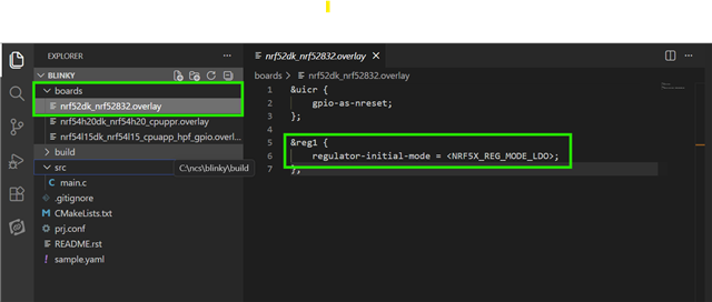

    I found the same .dts file with my specific board in the device tree and also changed the regulator to LDO (Picture 2)

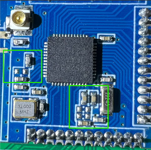

    Also important to note is that the module I am using does not have the components to support DC/DC, so it would be best to change to LDO to prevent any further damage before flashing you firmware. There are several unpopulated areas (Picture 3) which I hope will not affect BLE function.

  • Hi
    I would recommend that you change this in the overlay in your application rather then changing the dts for the 52dk. In general we always recommend that you create a custom board target that matches the HW for your board, as the mentioned DK might have different components then your board
    Regards
    Runar
