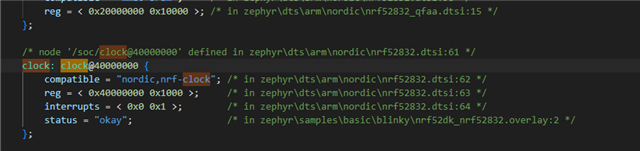

Inspecting devicetree_generated.h confirms the clock node is correctly resolved in the devicetree:
#define DT_COMPAT_HAS_OKAY_nordic_nrf_clock 1
#define DT_N_S_soc_S_clock_40000000_COMPAT_MATCHES_nordic_nrf_clock 1
#define DT_N_INST_0_nordic_nrf_clock DT_N_S_soc_S_clock_40000000
The node is present and status = "okay", so DT_HAS_NORDIC_NRF_CLOCK_ENABLED should be satisfied. However, Kconfig still reports it as a missing dependency for CONFIG_CLOCK_CONTROL_NRF.

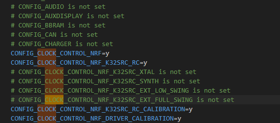

    I checked devicetree_generated.h and also reviewed my zephyr.dts and the generated .config file.
    Kind Regards,
    Abhijith
  • Hi, I’m getting the same output as you, but I also see that warning when I hover over the config in prj.conf. Could this be an IntelliSense issue?
    Okay, so this doesn’t affect the build. It looks like an editor mismatch rather than an actual Kconfig issue. Since the build output and generated files are correct, it’s safe to ignore, the hover tooltip is just a cosmetic issue.
