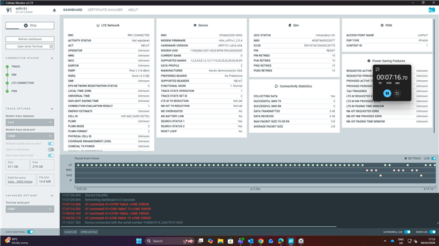

I want to use nRF9151DK and i have jio NB-IOT sim card.
I flashed asset tracker application from quick start and it is not working or connecting to internet  this is the celluler monitor report I'm attaching.

    My first guess would be that your RSRP (reference signal received power) might be too low to get a proper connection. Would it be possible for you to try from somewhere where you have a better connection with the cell tower?
    However, I'm missing quite a lot of information before I can make a good guess about what is happening. Keep in mind that my first guess might be wrong here.
    Can you please provide the full UART logs?
    Can you also provide the raw modem trace (.mtrace or .bin) from the cellular monitor?
    And just to be sure, did you activate your SIM card before trying to connect to the network?

  • Hi Simon,
    I have re-tested and observed some improvement in signal strength; however, the device is still unable to connect to the network.
    Kindly review the attached files for reference.

  • Hi Atul,
    The modem is detecting a reset loop. It can be caused by a lot of different things.
    In the traces, it looks like the either your SIM has not been provisioned or that you use the wrong APN for your SIM.
    I don't have experience with that particular SIM provider so it would be best to ask them directly to check if your SIM have indeed been provisioned and activated. And ask them what is the right APN for your SIM card.
