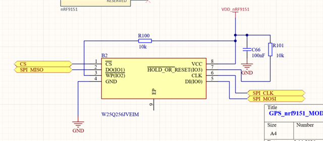

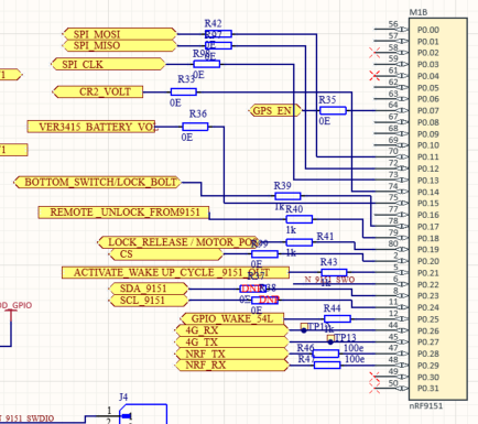

  • Hi Hung,
    We decided to use the 3 V SPI NOR flash from Winbond, the W25Q256JV, as an external flash for the nRF9151.
    Below are the relevant schematics and firmware configuration.
    Hardware:
    • SPI3 used for the flash
    • CS connected to the dedicated SPI CS line
    • HOLD#/RESET and WP#/IO2 are pulled up to VCC using 10 kΩ resistors
    • VCC = 3.0 V
    • Decoupling capacitor: 100 nF close to the flash
    • SPI signals routed directly from the nRF9151
    Device tree configuration:

    Could you please verify:
    1. Whether the hardware schematic connections look correct for the W25Q256JV
    2. Whether the device tree configuration is correct
    3. Whether CONFIG_SPI_NOR_SFDP_RUNTIME=y should completely eliminate the need for sfdp-bfp
    4. Whether the enter-4byte-addr = <0x01>; configuration is correct for this flash
    5. If there are any additional requirements for using the W25Q256JV with the nRF9151 external flash / PM subsystem.

  • Hi Akshay,
    I don't think you can use the sfdp-bfp from the GD25WB256 for the W25Q256JV.
    Could you try to test with CONFIG_SPI_NOR_SFDP_RUNTIME=y and  sfdp-bfp not added into the devicetree file ? As far as I know if you have sfdp-bfp in device tree it has more priority than the CONFIG_SPI_NOR_SFDP_RUNTIME.
    You can also test with the \samples\drivers\jesd216 . It will print out the sfdp-bfp for the specific chip.
    Please try to check on the SPI lines with a logic analyzer if you have correct signal coming out.
