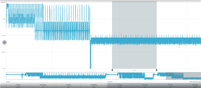

Hello together!
I am trying to reproduce the ultra low power connection as described in this whitepaper: /cfs-file/__key/communityserver-discussions-components-files/4/3482.Ultra-low-power-PPP-connection-using-nRF9151.pdf
Therefore, I am using the same hardware, i.e. the nRF9151-DK and the nRF54L15-DK. I downloaded the ncs-serial-modem v1.0.0 and compiled the firmware for both DKs using the description from https://docs.nordicsemi.com/bundle/addon-serial_modem-latest/page/samples/sm_ppp_shell.html and added the required overlays to both the serial modem app and the PPP shell sample. As described, I also disabled VCOM0 on the nRF54L15-DK. I used the exact same wiring as described and a PPK2 in source meter mode at 3.7 V to measure the current of the nRF9151-DK.
Everything works fine and I can connect to a network through the UART shell on the nRF54L15-DK, achieving IP connectivity.
But unfortunately, I am not able to achieve the floor current of 2 uA as described in the whitepaper, instead it is around 40 uA. Even after reset (without sending anything over the UART) the current does not drop below those 40 uA.
When trying the AT client shell sample from https://docs.nordicsemi.com/bundle/addon-serial_modem-latest/page/samples/sm_at_client_shell.html with the exact same setup I am able to achieve a floor/idle current of around 3 uA, which I would accept to be close enough to the "ideal" 2 uA from the whitepaper.
After all, I found a temporary way to reduce the current to 3 uA using the PPP shell sample too, which is:
- bring up IP connectivity
- reset the nRF9151-DK (push button)
- reset the nRF54L15-DK (push button)
I guess, through that procedure I probably break some CMUX or PPP state machine and it's not the intended way how it should work. Doing another reset on the nRF9151-DK the current goes back up to 40 uA.
Is there any additional configuration required to reproduce the setup from the whitepaper? Alternatively, would it be possible to share the source code and test procedure that were used for the measurements in the whitepaper?

    I have reported this to the modem team. It looks to me like a bug is causing this.
  • Modem team;
    It’s difficult to analyze without seeing the current measurement graph. But if the measured current stays at approximately 40uA level (instead of mainly 3uA + some high spikes that raise average), this sounds to me more like eDRX idle floor current without suspending SIM card. It might be worth trying with PSM only and disabling eDRX altogether with AT+CEDRXS=0.

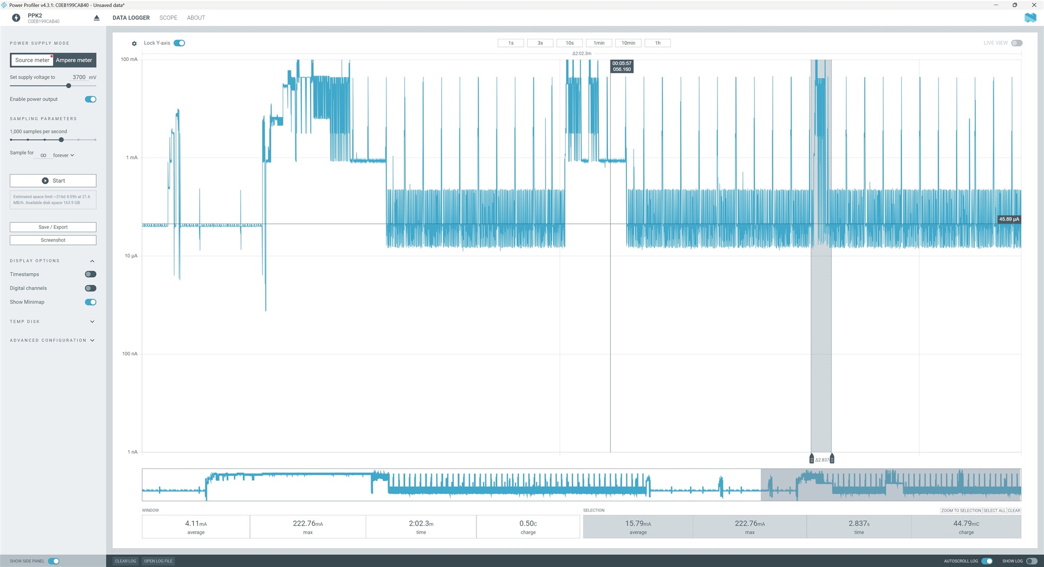

  • Hi!
    Here's a screenshot of my PPK2 current measurement of the nRF9151-DK:
    This is what I did:
    - The very first peak is due to a hardware reset on the nRF9151-DK.
    - After around 20 seconds or so I sent "net iface up 1" through the UART shell on the nRF54L15-DK
    - After around 1 min I sent "net ping 8.8.8.8"
    - After around 1min 30 seconds I sent "net iface down 1"
    Here's the log output from the shell (slightly sanitized):

    Regarding the new settings (PSM only and disabling eDRX altogether with AT+CEDRXS=0): May I ask for some Kconfig or code snippets etc.?

    I’m able to reproduce similar current consumption that the customer sees, when I enable eDRX only, and disable PSM. So it looks like eDRX and PSM are either not configured correctly, or the network operates so that eDRX setting is dominant, and PSM idle is not used.
    eDRX and PSM settings are saved to modem flash when AT+CFUN=0 is issued. My recommendation for testing that PSM idle works correctly:
    1. Flash sm_at_client_shell sample to nRF54 to be able to send AT commands.
    2. Connect terminal to nRF54 UART
    3. Power on modem:
      sm AT+CFUN=1
    4. Disable eDRX:
      sm AT+CEDRXS=0
    5. Enable PSM (with sm_at_client_shell, double quotes need to be escaped):
      sm AT+CPSMS=1,,,\”00101100\”,\”00000111\”
    6. Power off modem to save settings to flash:
      sm AT+CFUN=0
    7. Flash sm_ppp_shell sample to nRF54
    8. Reset both DKs.
    9. Start current measurement
    10. Connect terminal to nRF54 UART
    11. Bring up network interface:
      net iface up 1
    Idle current should be ~3uA after DUT has entered PSM idle, and UARTs are powered off:
  • Hi  ,
    The < 3 uA current can only be achieved in `CFUN=0` or PSM sleep mode. So the higher floor current might indicate that the PSM is not used.
    Please note that within the whitepaper, I suggested to modify Zephyr driver to enable custom eDRX and PSM settings. By default the Zephyr driver does not change any PSM or eDRX settings.
    I did a quick re-evaluation of current state of Serial Modem main branch with a modified modem driver for Zephyr. You can see the driver here: https://github.com/nrfconnect/ncs-serial-modem/pull/250
    These are a results on my desk, using network operator DNA in Finland. All measurements are suspect to be different on different networks. Some network might not allow eDRX.
    State
    1 min avg idle current
    after Serial Modem reset
    18 uA
    registered, no PSM or eDRX
    270 uA
    eDRX 20.48s cycle, 1.28s paging window
    155 uA
    eDRX 5.12s cycle, 2.56s paging window
    191 uA
    PSM sleep
    2.4 uA
    CFUN=0
    2.4 uA
