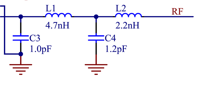

The matching network closely resembles the recommended network in the datasheet (shown in figure below). In my network, C3 = 0.8 pF, and L2 = 2.7nH due to availability of the components in our lab.

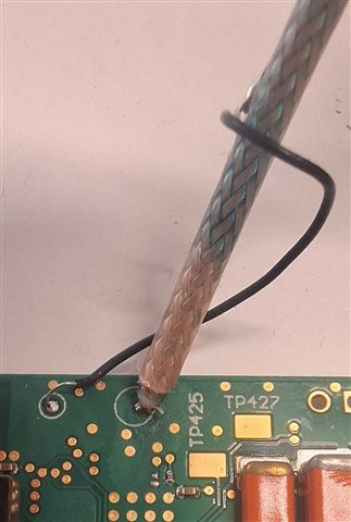

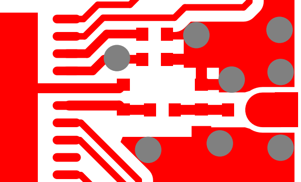

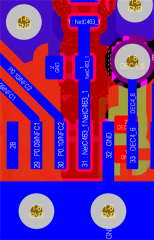

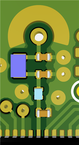

I'm also including a screenshot of the PCB. For this test, the capacitor at the output is not populated and a pigtail is soldered directly to the RF output pin to interface with the spectrum analyzer.

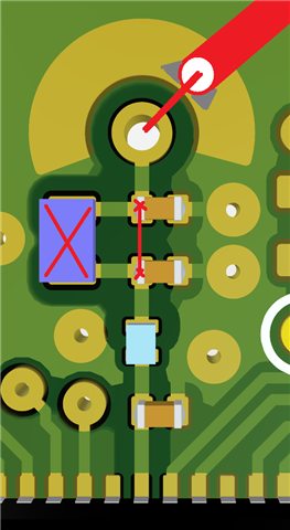

    The pigtail connection is not very good, the ground connection is not sufficient on these frequencies. You should solder the outer shield at the end of the coaxial cable to the ground very close to the connection point, trying to minimize the length of the discontinuity. Remove the large inductor (you could even remove the pads under it), and short the pads between the capacitors. (Ideally, you could also solder a 2.2nH 0201 inductor between the caps, if you have it, but it's not critical for this test, a short will do.) You can see what I mean in this sketch below:
    Do you know the part number of the 4.7nH inductor?

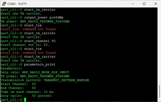

    We are testing the FW on a nRF52840-DK, however I'm already running into some issues for the Radio Test example.
    Here is what I did:
    - I programmed the nRF using the cli "nrfjprog --program radio_test_pca10056.hex --chiperase --verify -–reset"
    - The programming was successful, and my PuTTY terminal shows expected behavior.
    However, when I configure the tx carrier to start, nothing happens.

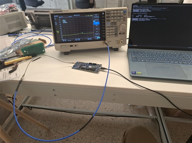

    I include a screenshot of my putty terminal and a picture of the setup. I'm using a 'MXHS83QE3000' cable to connect the DK to my VNA. As you can see, the VNA (showing 1 GHz - 3.2 GHz) measures nothing above the noise floor, while I'm expecting to see a carrier of  +8 dBm.
    Any suggestions what could be wrong here?

    It seems to me that the cable is connected to the wrong port on the instrument, shouldn't it be on the RF Input?
