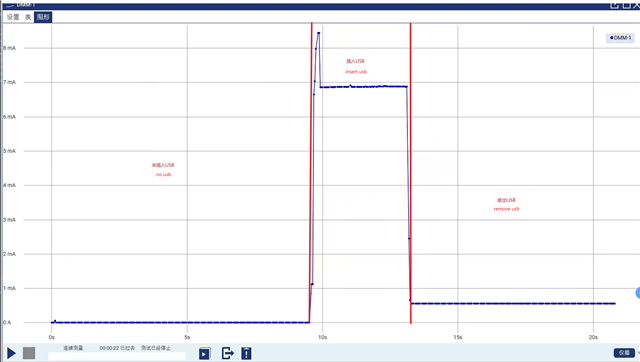

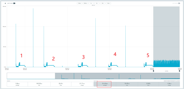

  • Hi strongman, how are you measuring this? using an Amp meter or a power profiler?
    I do not see the power consumption changes when you enable or disable  CONFIG_BT in prj.conf. I used the cdc_acm sample from NCSv3.2.4
    Can you give me your sample so that we are testing the same?
    Have you disabled logs? Have you disconnected the debugger usb wire while testing or does the debugger USB wire is still connected?
    • Measurement Tool: I am using an Amp meter to measure the current.
    • Logs & Debugger: I have not disabled logs, and the debugger USB wire is still connected during the test.
    I have attached my sample code below so we can ensure we are testing the exact same configuration.
