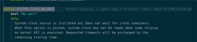

  • Thanks for confirming. I now remembered that the initialisation of the cryptocell RNG is quite time consuming. In addition to having CONFIG_SYSTEM_CLOCK_NO_WAIT enabled, please create a DT overlay to change the entropy source from the Cryptocell to the nRF RNG by changing the "zephyr,entropy" assignment in the "chosen" node:
