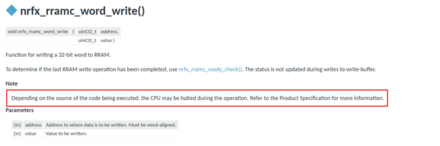

On the nRF54LM20A, can the CPU operate normally while RRAM is undergoing read, write, or erase operations?
On the previous nRF52833, the CPU cannot function normally during flash write or erase operations.
With the nRF54 series upgraded to RRAM, does a similar limitation still exist? Specifically, during RRAM read, write, or erase operations, can the CPU continue to run normally, and can interrupts be handled as expected?
I don't quite understand the statement that whether the CPU will halt depends on the source of the code. How should this be explained, and could you provide some examples?
