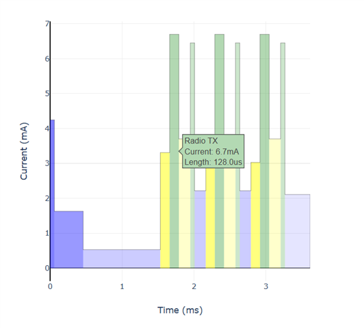

I'm currently developing an application using the ESB protocol on a nrf52840.

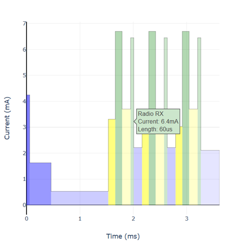

I'm trying to calculate the expected current consumption in the different stages of the connection process and measure with a DMM.
My current settings are:
- 2Mbps ESB
- 0dBm output power
- Clock = HFXO
- Regulator = DC/DC
- High voltage mode with REG0 out = 3.3 V

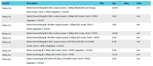

The table below reports some current consumption scenarios, but doesn't have the cases for high voltage mode and 2Mbps ESB. How should I expect my current to change?
