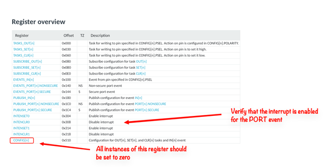

we have a custom board with the nrf54l15 and are doing power optimizations for standby. Our device will never go to SYSTEM OFF as the init draws to much power.
We expect a difference between SYSTEM ON idle and SYSTEM OFF of around 2µA, but we measure a difference of 17µA while sleeping with with k_sleep compared to sys_poweroff.
We checked all peripherals we used, but they seem disabled. Any ideas, where the 17µA could result from? Is there some code/tool, that goes through all peripherals and states what is still active?

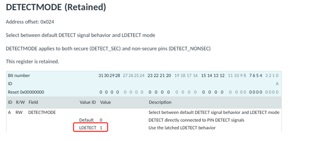

  • Good to hear, thanks for the update. With LEVEL triggering the interrupt will keep firing until the input signal is de-asserted. What you probably want in your case is to use GPIO_INT_EDGE_TO_ACTIVE in combination with the "sense-edge-mask" DT property. I agree that the information is a bit scattered, but we are actually already planning to include this in a devacademy course.
    The minimum pulse duration is about 10 us currently (you should add some margin here), but we have updated the drivers to support using the Latch detect mode which will shorten the required pulse with to around 1 us.
    Driver update: https://github.com/nrfconnect/sdk-zephyr/pull/3898
