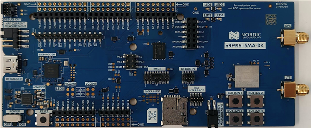

I am currently working on power consumption optimization using the nRF9151 DK (PCA10201).
Setup:
- Board: nRF9151 DK
- Measurement tool: Power Profiler Kit 2 (PPK2)
- Power connection:
- PPK2 VOUT connected to VDD-nRF
- PPK2 GND connected to board GND (P21)
- The jumper between VDD-5V and VDD-nRF is removed to isolate the nRF9151
Issue:

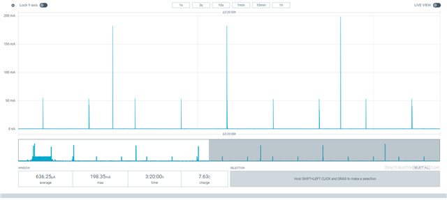

The modem appears to enter low power modes (eDRX and PSM), but the measured current remains around 670 µA, which is much higher than expected.
Measured vs expected:
- Measured current: ~670 µA
- Expected current: a few µA (based on Nordic documentation)
Configuration:
- eDRX configured with a cycle of ~22 minutes
- Multiple eDRX configurations have been tested (different values), but the current consumption remains the same
- Similar behavior observed when testing PSM (no significant reduction in current)

    Your setup for measuring current is correct.
    2. Could an active UART or another peripheral explain this ~670 µA consumption?
    Yes, this is usually the reason why you are seeing a higher floor current than 3 uA.
    3. Are there specific steps to ensure the system reaches true ultra-low power (µA range) in eDRX/PSM on the nRF9151 DK?
    Have you disabled UART for instance? Check if "CONFIG_SERIAL=n" is set on your side.
    Håkon
