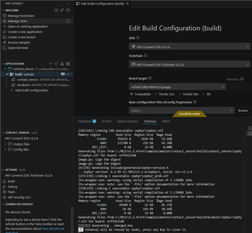

What is your build target? Is it nrf54l15dk/nrf54l15/cpuapp?
Could you try to delete the build folder and build again? Also, ensure the SDK and Toolchain are the same versions.
I cannot reproduce the issue building the Matter: Contact sensor sample for rf54l15dk/nrf54l15/cpuapp with NCS v3.2.4.

No, I didn't touch the example.
west build nrf\samples\matter\contact_sensor --pristine --board nrf52840dk/nrf52840 --sysbuild
