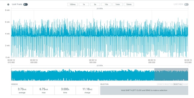

I measured the power consumption of the BLE RX using the nRF54L15.(nRF54L15-DK v1.0.0)
3.0V operation
apps: scan_adv (delete advertising)
west build -b nrf54l15dk/nrf54l15/cpuapp
proj.conf
CONFIG_BT=y
CONFIG_BT_BROADCASTER=y
CONFIG_BT_OBSERVER=y
CONFIG_LOG=n
CONFIG_SERIAL=n
Result: The average current consumption was 3.73mA.
This is 330uA higher than the 3.4mA stated in the datasheet.
Is this correct behavior? Is further processing required to reduce it to 3.4mA?

  • Hi
    Please explain what xx and yy is here, and if you're using the device in Ampere Meter mode or Source Meter mode?
    Simon
  • That seems to be correct, but this silkscreen doesn't seem to match an nRF54L15 DK v1.0.0, so can you show how the entire board, and how is the nRF54L15 DK powered here?
    And is the application you're running just the scan_adv sample without any changes?
    Simon
  • Yes. I downloaded it from the NORDIC website.
    I'll also upload the V1.0.0 P6 connector.
    Power is supplied via the USB connector.
    I'll upload main.c and proj.conf.
