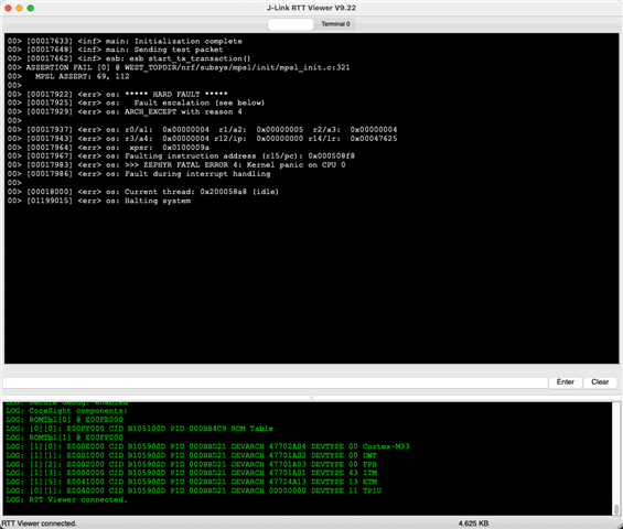

As the title, I have already tested the ESB routine (esb ptx Sample/esb prx Sample) by using nRF54LM20-DK + nRF54L15-DK. There was absolutely no problem. But when I added the ESB protocol to the nrf desktop routine according to the ESB routine, the routine couldn't run. The RTT output is as follows.
RTT output

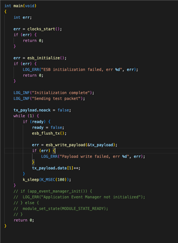

The main.c file has been modified as follows. This is to test whether the ESB protocol can run under the nrf desktop framework.
I need to enable the ESB protocol to run on the nrf desktop. When switching to ESB, the Bluetooth will be turned off. And when switching to Bluetooth, the ESB will be turned off.
