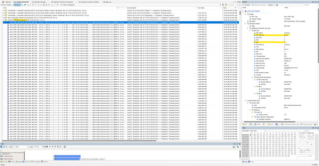

    Regarding differeces to the JBL Go 4 stream there are 2 parameters:
    • ISO Interval: 20 ms
    • BN: 2
    With the Auraconfig tool I could not set these parameter to the same value.
    Is it possible to modify these parameters?
    Tobias

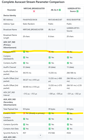

  • Ok, I could manage to set ISO interval = 20 ms and BN = 2.
    The stream still does not work.
    Meanwhile I tested a 3rd transmitter (UGREEN-BT701-Source).
    This transmitter is also working with the Airoha chipset.
    I tried to compare the config.
    I see a difference regarding the Advertising Address, nRF5340 send this in the primary advertising packet and the two others in secondary.
    I tried to configure sending AdvA in the Secondary packet, but it seems to be controlled by the stack.
    Do we have any options?
    Tobias
