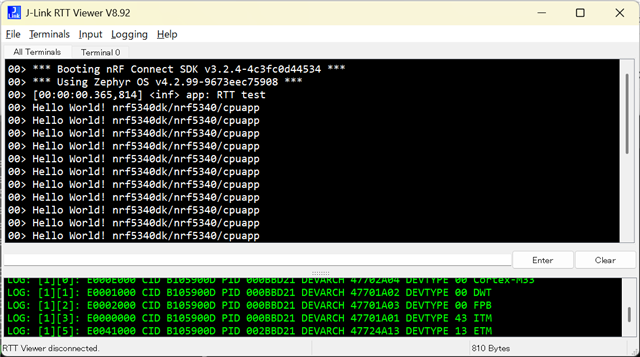

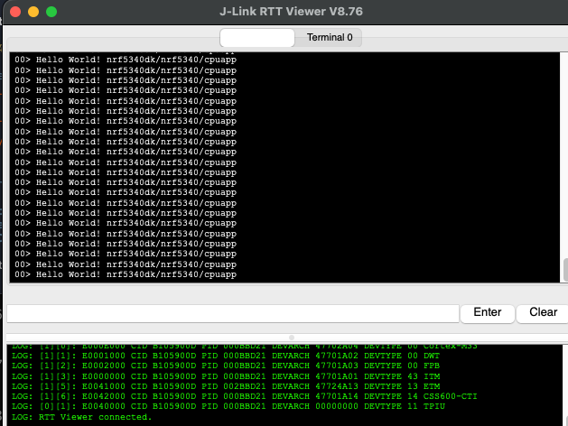

    The program has reached the main() function. I confirmed this by toggling the LED.
    Gotoda
  • When I write the provided hex file, "Hello World!" is displayed in the RTT Viewer (updated two lines every two seconds).
    I tried adding that main statement to the Connectivity Bridge's default code, but nothing is displayed in the RTT Viewer.

  • I have selected Flash in VS Code. The following is displayed in the Terminal:
    west build --build-dir c:/ncs/applications/connectivity_bridge_v3-2-4_v2/build c:/ncs/applications/connectivity_bridge_v3-2-4_v2 --pristine --board thingy91x/nrf5340/cpuapp
  • OK, that looks like the right board to me. No glue, what goes wrong.
    I tried with the connectivity bridge app myself now. Note that the logger configuration in prj.conf gets overridden by the board specific kconfig fragment in the "boards" folder. I also found that the image got to big when I enabled logging so had to disable the DAP debugger functionality to free up enough FLASH to enable the logger.
