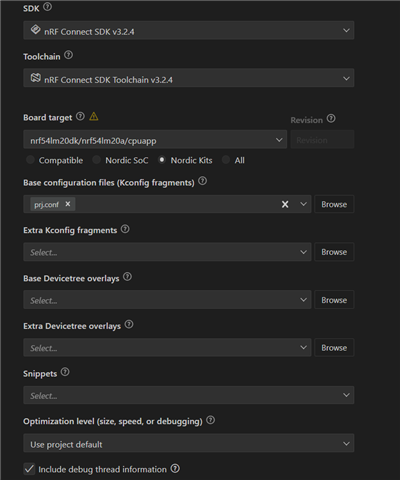

I'm working through the fundamental courses and trying to get my nrf54lm20 development board setup. After I have built and flashed the sample firmware to the dev board. There had been no LED lighting up on the board nor any messages logged when listening on the emulated terminal. The emulated terminal had no message showing up. I'm unsure if the board is even starting after flashing the firmware. There were no error messages during the build or flashing process. Both finished normally.
Below is the build configuration used and the flash logging messages. It is building with the default configurations with sysbuild. As a side note, the flashed firmware was working normally with hello world applications.

    Yes, I'm trying to use the Bluetooth LE LED Button service. The same result happened when I tried later exercise solutions. As for other targets, I only have nrf54lm20 DK. I've tried this on two different board so I don't think its an hardware problem on specific boards.
    For your information. When I was testing with other apps the same behaviour started appearing when I added `CONFIG_BT=y` in the prj.conf file. Even if no bluetooth related function was used in the code.

  • The board configurator shows the LED is on. After flashing the terminal outputs no logging message, this includes both the logging messages in the sample application and the two lines that outputs the version of the sdk and Zephyr. So I'm not sure the board even boot successfully after flashing.
    What revision number is being used? Could you please try the following: Flash Blinky sample (so that we can check if the LEDs & GPIO are working properly and the board is correctly programmed), use the board configurator to modify VDD (set low at 1.7) and then reset. See if the LEDs work by doing this.

  • Hi.
    The LED and the blinky sample does work. and the board has revision number 0.7.0.
    I tried to run debug on the board, the output through RTT after enabling BT in the proj.conf are the following. And the second chunk is what was outputted when running west debug, listening for the address then running backtrace.

  • The problem was fixed after updating the sdk version. It seemed like a problem building the older SDK, building with v3.3.0 with nrf54lm20b as the target fixed the issue.
    The development kit's description on the site did say it needed the v3.3.0 previews SDKs at least, but it wasn't mentioned in the courses.
