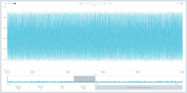

When using hello_world without any modifications but only disable console and serial, I have a current profile like shown in the below figure. This is again, with empty network core. This gives me an average current of 250 uA.

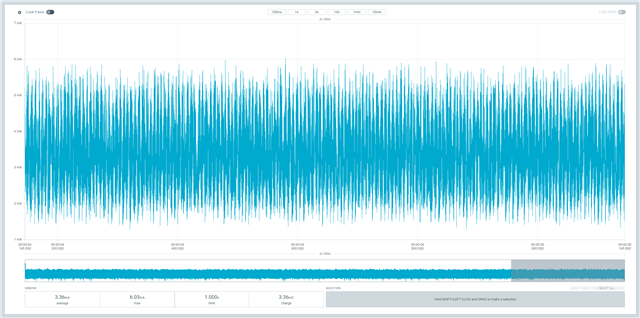

However, when using hello_world with the above configurations, I have this current profile as shown in the next figure. This gives me an average current of 3.36 mA although I did not call bt_enable() at all in my code.
So simply enabling ipc_radio image on network core without actually use BT function is giving this much current consumption increase. Is this the expected behaviour? If not, what could be the optimisations to reduce this current consumption? I understand when both cores are enabled, there is this internal communication between the two core, is this the reason?
    The floor with the empty network core is also seems higher than expected (should normally be around 2 uA). Do you have any external circuitry on your custom board that would make this level expected? And do you see the same if you instead use the nRF5340DK as your build target?

    The total system current, with your app running on the application core and ipc_radio on the network core should be around 3 uA during idle. The fact that you are seeing 3+ mA suggests that ipc_radio is not running correctly. Perhaps it is entering a boot loop. Either way, I would start with trying to use the DK as the build target to see if we can get to the expecte sleep current. The thingy target is including a lot of other things in the build such as mcuboot which could make troubleshooting more complicated.
