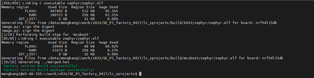

    2,  This is the compilation log when closing VNet FORCE-COVERAGE=n, VNet COVERAGE_GCOV=n, and VNet COVERAGE=n:
    Thank you for the additional information. Since your partitions indicate that you are using dual bank DFU, this overflow is not very surprising.
    Your application is already at 85% of the allocated flash before enabling the coverage symbols. Would it have any value for you to do a coverage test without the DFU configurations? It could at least shed some light on how much the memory usage increases when enabling the coverage symbols. If it seems feasible with those numbers that you could be able to fine tune your partitions to barely fit the application with the coverage symbols enabled, then I'd say you should give it a try. But do please note that we don't recommend shipping products with 100% flash usage because it can make it impossible to perform future upgrades.

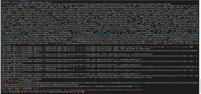

  • Hi
    This issue is not about configuring flash partitions to allow enough space for firmware to flow out. I have also tried using this routine nrf/samples/blue/peripherals_uart to add CONFIG_FORCE_COVERAGE=y, CONFIG_COVERAGE_GCOV=y, and CONFIG_COVERAGE=y in prj.conf, which will also report the same error during compilation. Therefore, I believe that using these three configurations is not suitable for the nrf54l15 chip. What is the correct way to test code coverage on nrf54l15 using ztest.
    The following is the log compiled from prj.conf in nrf/samples/blue/peripheral-uart with the addition of CONFIG_FORCE_COVERAGE=y, CONFIG_COVERAGE_GCOV=y, and CONFIG_COVERAGE=y
    Yes, I see this now. I see the same when adding the coverage symbols to Zephyr samples. So the RAM and NVM requirements that coverage has is too large to run on the nRF54L15. Instead of running on the hardware, you could check out using Twister instead to generate coverage reports.
