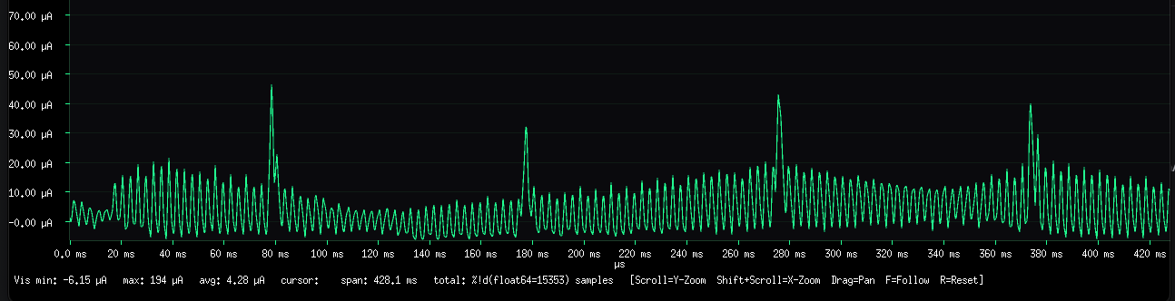

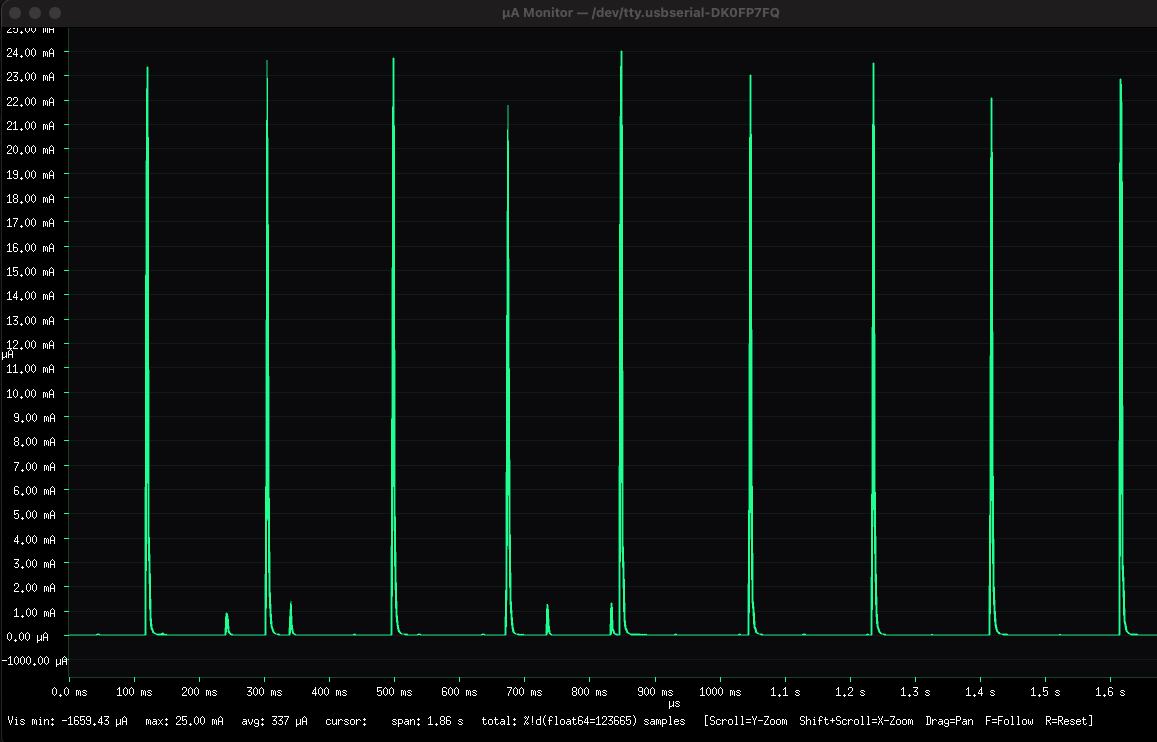

Im developing RTLS with DWM3001C and right now Im working on personal tag powered by CR2450. So naturally, power consumption should be as low as possible.
So far I managed it to these levels - idle not moving - around 15-20 uA, after moving tag UWB TX is around 22-30 mA spike, and periodically there are every 100ms spikes of 60 uA +/- from accelerometer sampling.
Over past year, i tried everything possible but this is as low as it gets... from what i read it should be able to go 5 uA +/- ?
Any help will be appreciated :)
IDLE consuption
Pinging

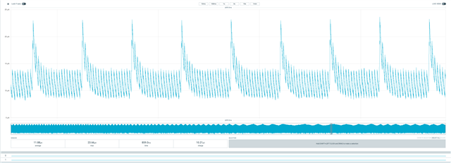

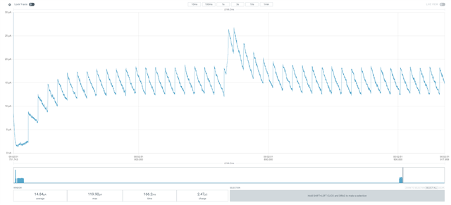

    But meanwhile... we bought PPK II :) so here are results...
    This is when device finishes TX and goes to deep sleep... it stabilizes on 13-18 uA ticking...
    This is deep sleep interval... peaks to 28 uA are IMU (LIS2DH12) readings...
    DWM should consume around few nA in this state and only thing which should burn power now is LIS sensor
    but it is ODR 10hz and LOW POWER mode... in this mode it should consume on average 3-5 uA ? So it still appears to me that NRF is doing something that is consuming power.. or if average calculation of PPK2 is anything to go by... could this be correct ? 5 +/- uA of nrf sleep + 5+/- uA of LIS2DH12 working could average on 12 uA as in picture...
