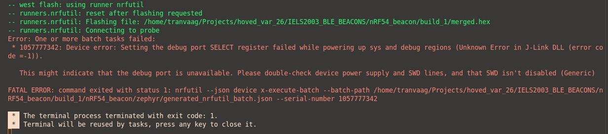

We are a student group from NTNU which is developing an BLE Audio Beacon using the nRF54L15 socket and the nPM1300 PMIC. However, we have ran into some issues when trying to flash the board using the debug out connector from the nRF54L15 DK. We have soldered multiple boards and get the same error message on all of them:
This happens on all the boards, flashing from different computers and with different devkits. The SWD_SELECT pin is connected to GND on the custom board:

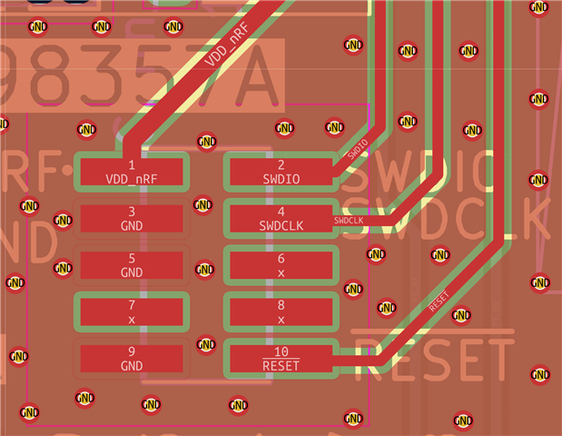

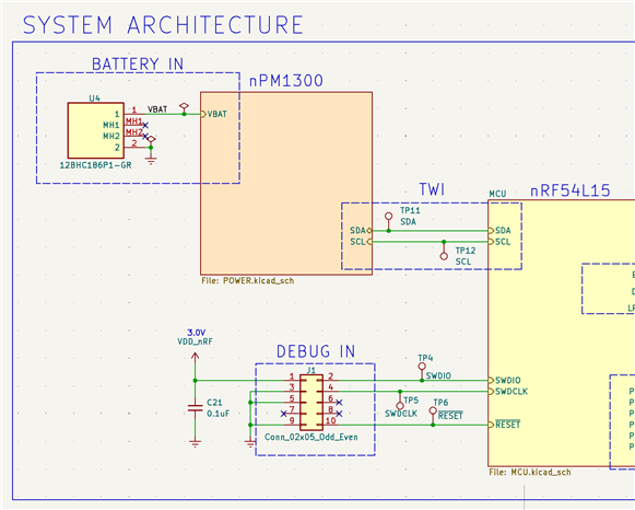

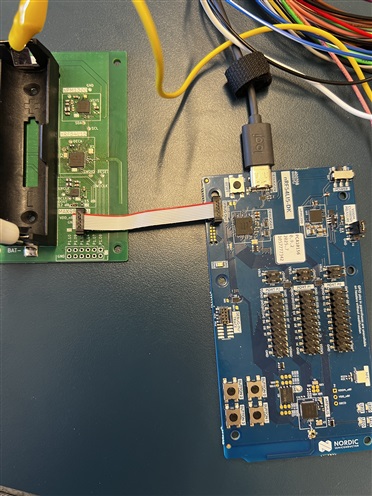

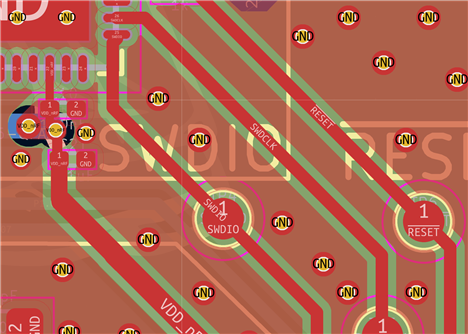

Below are pictures from the schematic and the debug connection to the custom PCB.

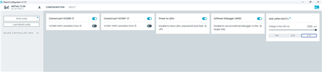

    It seems like debugger port is unavailable. Is the nRf54L15DK and your customer board are powered by same voltage level? You can set the VDD on board configurator app on the nRF Connect for Desktop app.

    Yes, we have set the level to 3000 mV, which is the same measured on the nRF, and it doesn't change the outcome while flashing. The connections checks out with the debug out connector from the link you sent. Do you have any other suggestions?
