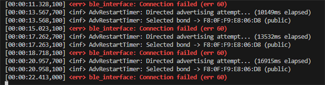

I use a 30-second window where the device tries to reconnect to the bonded peer before falling back to normal advertising. I’ve tested two methods
  • Directed Advertising (ADV_DIRECT_IND): I consistently get Error 60 (ETIMEDOUT). I understand this has a 1.28s hardware limit, but even within that window, my Android phone fails to connect?.
  int err = bt_le_adv_start(
      BT_LE_ADV_PARAM(BT_LE_ADV_OPT_CONNECTABLE | BT_LE_ADV_OPT_DIR_ADDR_RPA,
                      BT_GAP_ADV_FAST_INT_MIN_2, BT_GAP_ADV_FAST_INT_MAX_2, &bond_addr),
      NULL, 0, NULL, 0);

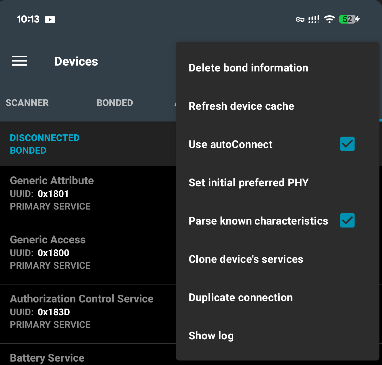

  • Filter Accept List (Whitelist): This works better for manual connections, but the Android Native AutoConnect (tested via nRF Connect App) is not triggering as expected unless the app is active.

  • The AutoConnect in nRF Connect App (Android): Why does the AutoConnect feature in the nRF Connect App Android remain idle during my Filter Advertising or Direct Advertaising window? Is there a specific requirement (Flags, Appearance, or Service UUIDs) for the Android OS to "wake up" and initiate the connection?
  • Why does Directed Advertising fail with Error 60? Is it because the phone's RPA resolution takes longer than the hardware timeout allowed by the stack?

    I think the auto connect issue you have is that the nRF Connect app doesn't scan unless you tell it to, usually by refreshing the SCANNER page by dragging it down, then it should auto-connect to a bonded board where you have checked this box.
    Do you also make sure the Android device is actually scanning when you're trying to do direct advertising. I assume you do multiple attempts after one another when trying this? If not, you should make it try multiple times if it fails, and make sure the Android does scan for devices.
