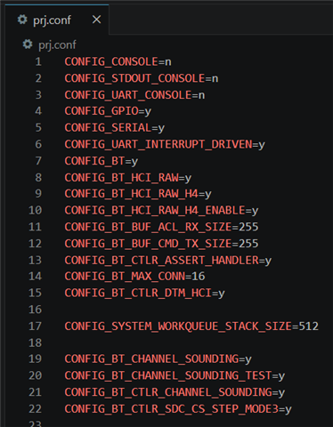

I created an HCI UART application using nRF Connect for VS Code with NCS v3.2.4 and enabled the Channel Sounding component via the nRF Kconfig GUI (added to prj.conf).

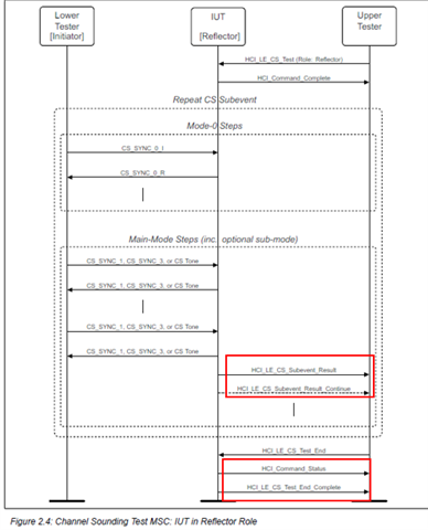

1. RX comparison for LE_CS_TEST command
Nordic (Reflector):
01 95 20 2b 01 ff 00 03 01 00 01 01 ff 08 3d 00 00 00 7f 91 91 96 28 00 00 00 ff ff 00 00 01 29 00 0d 03 15 15 15 00 85 57 b2 36 78 6e e1 a1
Silicon Labs (Initiator):
01 95 20 2b 01 ff 00 03 00 00 01 01 ff 08 3d 00 00 00 7f 91 91 96 28 00 00 00 ff ff 00 00 01 29 00 0d 03 15 15 15 00 85 57 b2 36 78 6e e1 a1
Common behavior:
Both DUTs respond successfully to the LE_CS_TEST command with:
04 0E 04 01 95 20 00
Difference:
  • When the Reflector is prepared first and the Initiator starts transmitting:
    • Silicon Labs DUT responds with LE_CS_Subevent_Result event
    • Nordic DUT shows no additional response
2. RX behavior for LE_CS_TEST_END command
Command:
01 96 20 00
Nordic:
  • Responds with HCI_Command_Status (0x0F)0x0C (Command Disallowed)
  • No LE_CS_TEST_END_COMPLETE (0x3E) event
Silicon Labs:
  • Responds with HCI_Command_Status (0x0F)0x00 (Success)
  • Followed by LE_CS_TEST_END_COMPLETE (0x3E)0x00 (Success)

Based on the Bluetooth specification, it seems that the Nordic DUT behavior differs from the expected response (especially for LE_CS_TEST_END and missing LE_CS_Subevent_Result).
Could you please advise:
  • is there any configuration (Kconfig / HCI / role setup) that I might have missed?
Any guidance would be greatly appreciated.
