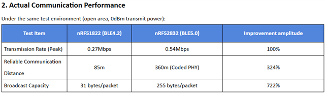

the product from BLE 4.2 change target device to BLE 5.0, the expected transmisson distance could be increased by the least 100%, but the actual connection distance was only 2/3 of the original.
Q:Do I need to make any further settings in the program to enable longer transmission power? How do I set it up?

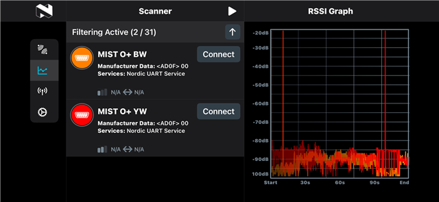

The following RSSI records are data from two devices at the same distance(1.5M)

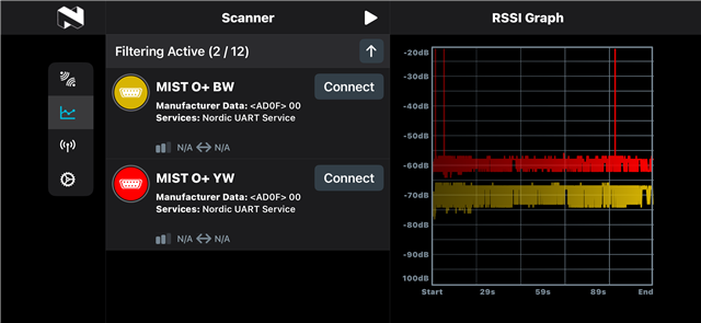

The following RSSI records are data from two devices at the same distance(0.2M)
BLE4.2 consistently offers higher transmission power than BLE5.0.
