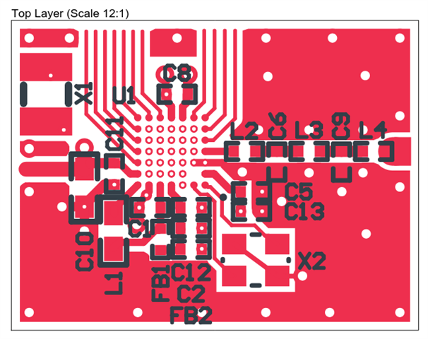

In document nRF54L15_qfaa_4L_config1_pcb_reference_layout_0_6 there is a representation of the PCB with 4 layers. The GND of C9 is not connected on the top layer, nor on the inner layers, but only on the bottom layer using vias.
In document nRF54L15_caaa_config1_pcb_reference_layout_0_3 , ithere is an 8-layer representation: the GND of C9 is still not connected on the top layer, but it is connected to all the inner layers and to bottom.
For a 6-layer PCB, which configuration is correct? The one where only the top is connected to the bottom, or the one where the top is connected to all the layers?
