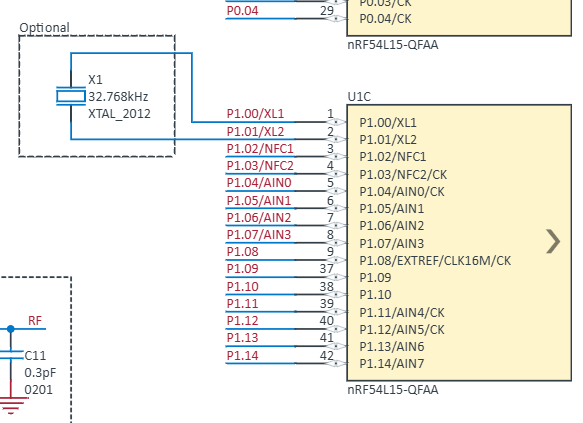

nRF54L15 ADC channels not reading correctly
I’m working with nRF54L15 (nRF54L15 DK) using NCS v3.0.2, and I’m facing an issue with ADC channel readings.
I configured the following ADC channels:
  • AIN3 → P1.07
  • AIN6 → P1.13
  • AIN7 → P1.14
Devicetree overlay

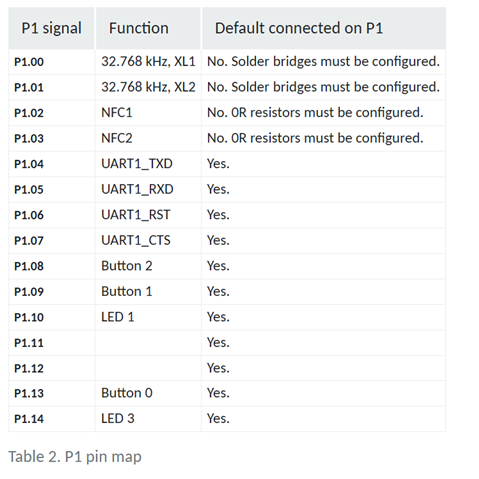

Observed behavior
When connecting the sensor:
  • On P1.13 (expected AIN6) → only AIN7 channel shows valid readings
  • AIN3 and AIN6 always return ~4092 (full-scale)
Example output:
CH0 (AIN3 / P1.07): 4092
CH1 (AIN6 / P1.13): 4092
CH2 (AIN7 / P1.14): 2532
Additionally:
  • Connecting the sensor to P1.07 or P1.14 does not change readings
  • Only P1.13 seems to affect ADC output, but it appears on AIN7
Questions
  1. What is the correct AIN - GPIO mapping for nRF54L15 DK?
  2. Are P1.07 and P1.14 valid ADC input pins?
  3. Is any additional configuration required for ADC inputs on nRF54?
Any guidance on correct ADC channel  pin mapping for nRF54L15 would be very helpful.
