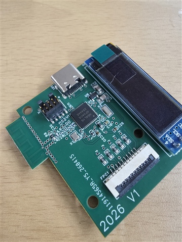

I recently designed and ordered custom nrf54l15 board but i cannot connect it through JLINK

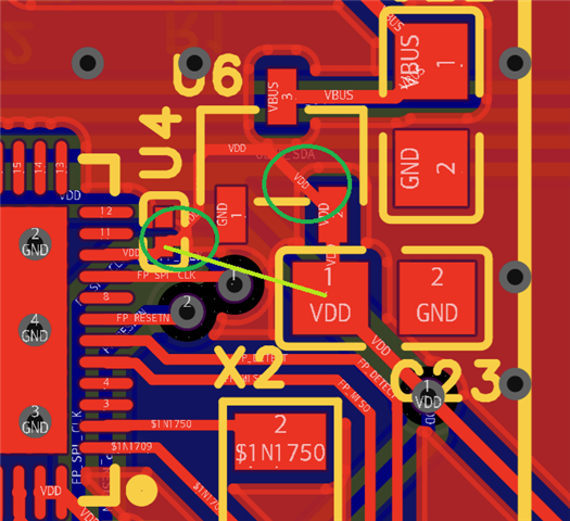

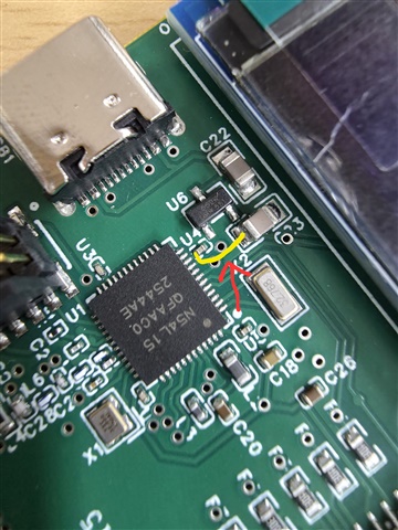

On PCBA, I forgot to connect the pin 10 to vdd. There was only a decoupling. So i soldered it to the vdd line. Solder was clean.
This is circuit board
And i soldered like this

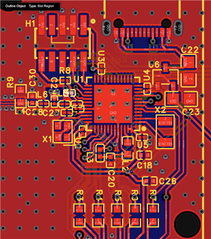

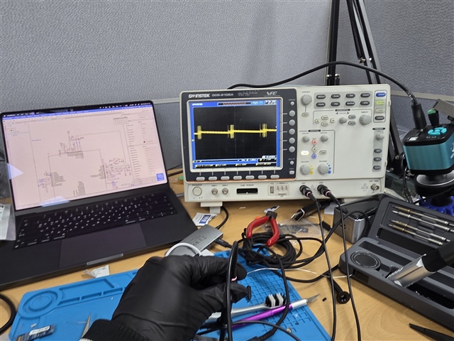

  • UPDATE:

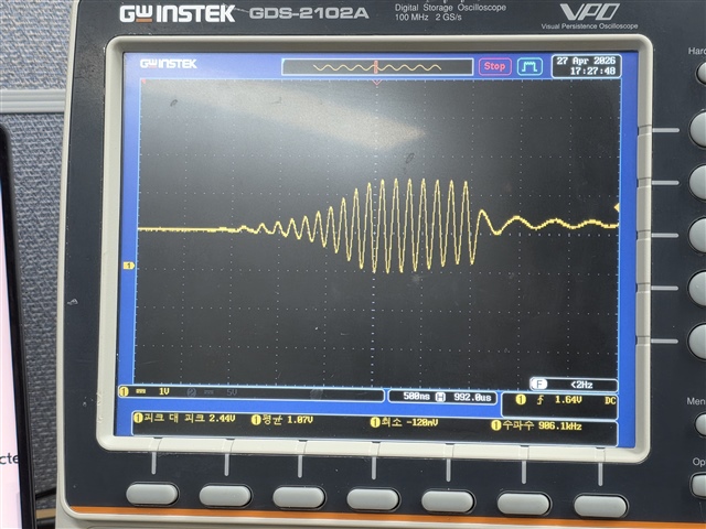

    Found weird volatge peaking on DECA.
    Trying to feature out the root cause. Maybe due to putting C21 on bottom size connected with via...?
    Peaking rate is approximately 51Khz
    UPDATE: Tried to cut the line that connects DECA and DECRF. DECRF was fine. DECA still makes some speak graphs
    UPDATE: removed C21. and.. it worked... why......?

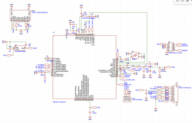

    what you are seeing here is probably L3 and C21 resonating (forming an LC tank circuit). On your schematic, you are missing a 2.2 uF capacitor on the DECA/DECRF net, that could probably explain the problem.
    On the PCB, a VDD trace is overlapping with the GND plane, where you made the rework. Did you cut this trace? (edit: I see that the actual PCB is different, as the capacitor is rotated.)
    Did you verify there is no short circuit, and all supply voltage levels are correct? 1V sounds a bit low, the internal voltage should be around 1.2V. What I see on the scope, is that the regulator fails to start correctly and tries again periodically.
  • Oh it was not applied on pcba. I did it after i got a board. And board works fine with 2.2uF Thanks!
