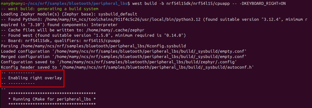

I added a cmake configuration option to CMakeLists.txt, but sending a value through west build does not set the cmake option. Here is what I have done:

The build command:
west build --pristine --build-dir $HOME/src/leaf-fall/firmware/keyboard/build --board nrf52_adafruit_feather/nrf52832 -- -DKEYBOARD_RIGHT=ON
The result shows that KEYBOARD_RIGHT is getting ignored by both sysbuild and the application build:

   * Running CMake for keyboard *
-- Enabling left overlay

-- Enabling left compile option
