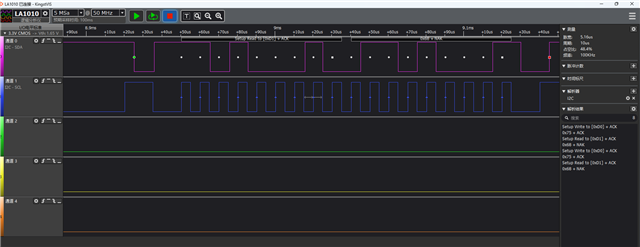

I2C frequency in NCS V3.2.0 nrf52833
The device tree configuration rate is inconsistent with the actual rate.
Device Tree Configuration
&i2c0 {
status = "okay";
clock-frequency = <I2C_BITRATE_FAST>; //I2C_BITRATE_STANDARD(100000) 250000 I2C_BITRATE_FAST(400000)
Verification via code:
/* Read frequency directly from devicetree properties */
uint32_t freq = DT_PROP(I2C0_NODE, clock_frequency);
LOG_INF("i2c0 ready (freq=%u Hz)", freq);
Output: i2c_drv: i2c0 ready (freq=400000 Hz)
    Could you check in you application code, whether you are maybe using the I2C_BITRATE_STANDARD or whether some snippet in the code is actually calling the standard rate ?
    This can override the dts setting.
    -Priyanka
  • You could maybe attach your code (do let me know in case I need to make the case private for this) and I can take a look at it.
    -Priyanka
  • One issue which can cause slower than expected clock rates with i2c is the nRF52833 mistakenly thinking the i2c slave is requesting clock stretching; this can occur by using too-soft drive levels on SCL and SDA (S0D1) particularly at 400kHz. Fix - advisable in any case for i2c at 400kHz - by forcing high-drive (H0D1) and ensuring the pull-up resistance to VDD is low enough, perhaps 4k7 or less. If the i2c slave is on a single bus and never requests a clock stretch, H0H1 can be used.
    The trace waveforms captured are very misleading as they are on a digital logic analyser; using an oscilloscope would show that SCL in particular is very soggy with a slow rise- and fall-time; it is this slow rise & fall which makes the nRF52833 think the clock is being externally held low for a time (which is interpreted as a clock stretch) and sharpening up those clock edges can provide a solution. The longer the i2c SCL connection the worse the problem due to parasitic capacitance.

    Worth checking with a debugger that zephyr stuff doesn't defeat this high-drive setting, and if using 10k pull-ups reduce that to 4k7 or less ..
