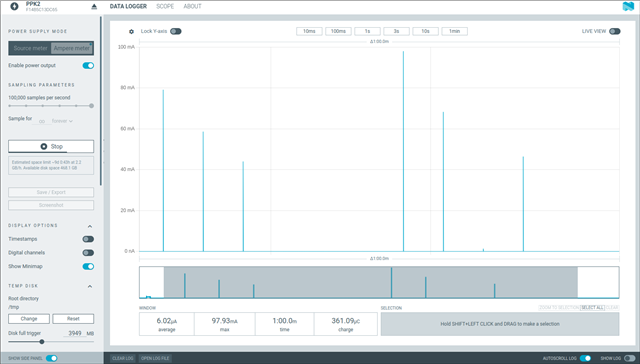

    I just tried your sample on a nRF54L15 DK and the chip itself draws only 6uA.
    My guess is that, it is not the nRF54L10 that actually draws most of the 130uA.
    Can you please show me a schematic of how you are measuring the current, and what components are after your current probe? (If you want to share some confidential information, just ask me to convert this ticket to private before sending the files)
