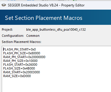

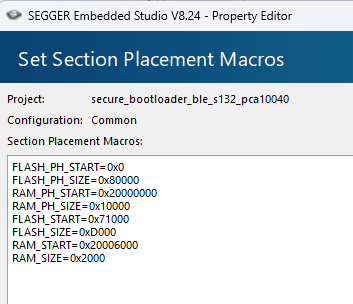

nRF52832 Secure DFU: Succeeds at 100% but fails to reconnect (GATT Error 133)
Hardware: nRF52832 (BM832 Module)
Programming setup: Custom board connected via Debug Out pins of nRF52-DK (PCA10040)
SDK Version: [nRF5_SDK_17.1.0_ddde560]
SoftDevice: S132
Description: I am implementing Buttonless Secure DFU on a custom nRF52832 module. I recently moved my bootloader start address to 0x71000 to accommodate a larger bootloader size. While the nRF Connect app (Android) shows the DFU transfer reaching 100% and the bootloader seems to "execute" the data object, the reconnect attempt to the application fails with GATT ERROR 133 (0x85).
Observations from nRF Connect Log:
  1. Jump from Application to Bootloader (...EB to ...EC) works correctly.
  2. During the transfer, I occasionally see Error 8 (0x8): GATT INSUF AUTHORIZATION or GATT CONN TIMEOUT, but the nRF Connect app seems to recover and continues the upload.
  3. Final Data object executed notification is received.
  4. Reconnection attempt to original address (...EB) lasts 10 seconds and ends with Error 133 (0x85).
  5. After the failure, the device is not advertising.
What I have tried:
  • Verified UICR matches the linker FLASH_START.
  • Performed a full chip erase and re-programmed the stack.
  • Verified that the application binary size (approx 96KB) is well within the Dual Bank limits for this layout.
Questions:
  1. Could the GATT INSUF AUTHORIZATION error during the transfer be causing a post-update validation issue, even if the transfer reaches 100%?
  2. Since I am using a custom BM832 module, are there specific reset or power behaviors after the DFU swap that could lead to a GATT 133 error?
  3. Does the S132 require specific RAM adjustments if the bootloader is moved to a lower address like 0x71000?

  • Thanks for the suggestions!
    I'm using a bare BM832 module via the nRF52 DK Debug Out pin (so I don't have built-in LEDs/buttons for signaling) and I am not using bonding or user data retention.
     If I completely erase the chip and flash all the files natively via USB (softdeviceappbootloadersettings.hex), the application boots and advertises perfectly
    However, if I erase and put the board in Bootloader mode, upload the app.zip via phone, the phone says "Success." The bootloader resets, but then the module goes completely silent and fails to advertise.
    I dumped the MCU registers (nrfjprog --readregs) and saw a Software Reset (0x04) took place.

            nrf_pwr_mgmt_run();
    /**@brief Function for application main entry.
        // --- START ROBUST HANDOFF ---
        // Clear the DFU request flag to prevent the bootloader from pulling us back.
        if (nrf_power_gpregret_get() != 0x00)
            nrf_power_gpregret_set(0x00);
        // Clear reset reasons to ensure a fresh state
        uint32_t rr = NRF_POWER->RESETREAS;
        NRF_POWER->RESETREAS = 0xFFFFFFFF;
        // BREADCRUMB: If you read 0xEE in GPREGRET, the app successfully reached main()
        nrf_power_gpregret_set(0xEE);
        // --- END ROBUST HANDOFF ---
        bool       erase_bonds;
        ret_code_t err_code;
        log_init();
        NRF_LOG_INFO("--- APP STARTING (RR:0x%x) ---", rr);
        NRF_LOG_FLUSH();
        // Give hardware time to settle after the Bootloader-to-SoftDevice jump
        nrf_delay_ms(100);
        // Initialize the async SVCI interface to bootloader before any interrupts are enabled.
        err_code = ble_dfu_buttonless_async_svci_init();
        if (err_code != NRF_SUCCESS)
            NRF_LOG_WARNING("SVCI Init failed (expected if no Bootloader is flashed): 0x%x", err_code);
        timers_init();
        power_management_init();
        // buttons_leds_init(&erase_bonds); // COMMENTED OUT for custom board testing
        erase_bonds = false;
        ble_stack_init();
        peer_manager_init();
        gap_params_init();
        gatt_init();
        advertising_init();
        services_init();
        conn_params_init();
        NRF_LOG_INFO("Buttonless DFU Application started.");
        // Start execution.
        application_timers_start();
        advertising_start(erase_bonds);
        // Enter main loop.
        for (;;)
            idle_state_handle();
