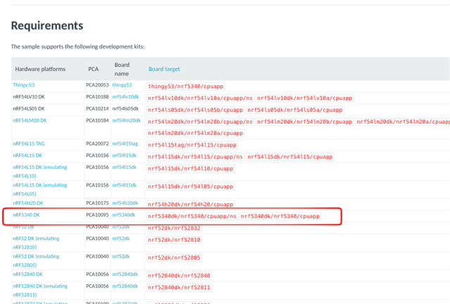

  • The hello sample builds with an empty net core by default IIRC.

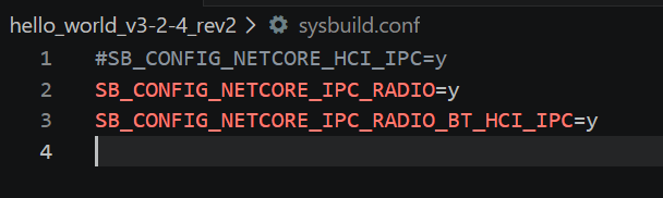

    Using one of the nrf BT samples should yield a working build with a proper BTLE enabled net core image.

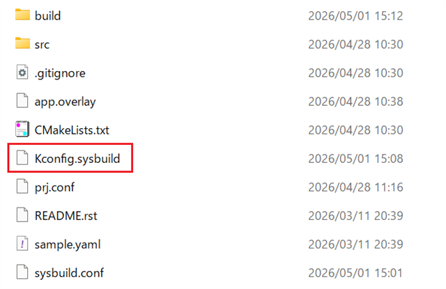

    Net core image is specified in the sysbuild.conf file.
  • I can confirm that the regular Hello world does not include anything for the network core. When working with Bluetooth, you need to include the IPC Radio application on the network core. This can be done either by adding a sysbuild.conf file in your project with SB_CONFIG_NETCORE_IPC_RADIO and SB_CONFIG_NETCORE_IPC_RADIO_BT_HCI_IPC set to "=y", or by copying the Kconfig.sysbuild file from one of our Bluetooth samples like this one https://github.com/nrfconnect/sdk-nrf/blob/main/samples/bluetooth/peripheral_uart/Kconfig.sysbuild
  • Then I assume it must be built without "sysbuild" enabled (default) as is required for building multiple FW images in the same project. Please edit the build configuration in VS code and make sure to select the checkbox for enabling sysbuild at the end.
  • I tried building using sysbuild, but the problem was not resolved.
