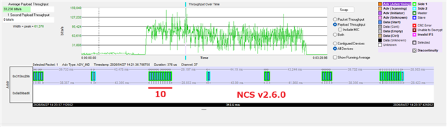

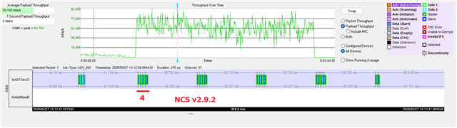

BLE throughput differs between NCS v2.6.0 and v2.9.2.
v2.9.2 appears to have fewer MoreData packets.
(Both have CONFIG_BT_CTLR_SDC_MAX_CONN_EVENT_LEN_DEFAULT set to 7500)
In v2.9.2, I confirmed that setting `CONFIG_BT_CTLR_SDC_MAX_CONN_EVENT_LEN_DEFAULT=15000` changes the number of more data packets.
Is there a difference in how `CONFIG_BT_CTLR_SDC_MAX_CONN_EVENT_LEN_DEFAULT` is handled between v2.6.0 and v2.9.2?

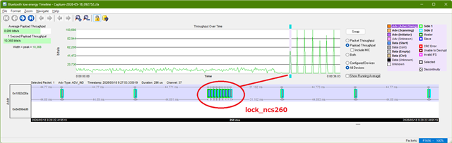

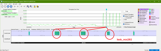

    Is the ncs260 device and ncs292 device running on the same exact HW, and under similar conditions? The reason I ask is that I can't seem to see any difference in behavior, but there seems to be a bit more packet loss in the latter trace.
    That said, it seems like both traces show a chunk of 158 byte long messages. Sometimes 6 packets, sometimes 5 and sometimes 4. Not an awful lot of data.
    Do you mean that they should always be the same? E.g. 5 or 6 packets?
    Where in your application (both in 2.6.0 and 2.9.2) do you transmit this data?
    Regardless of packet loss, the data should go through, as long as it is queued with a return value of Success (0).
    Can you confirm that this is the case? That you check the return value when you queue up the data for TX?

    Both ncs2.6.0 and ncs2.9.2 are being operated on the same DK board. I have sent the project files, so could you please perform a packet capture on the Nordic side as well?
    Here is the background regarding this issue:
    1. We discovered that the throughput differs between ncs2.6.0 and ncs2.9.2 in a certain product, with ncs2.9.2 being slower. After capturing the BLE packets, we confirmed that the number of "More Data" packets differs between ncs2.6.0 and ncs2.9.2. This was the starting point of the DevZone topic.
    2. Samruddhi Jadhav requested that we provide the project.
    3. I have created and provided a test project for the DK board so that the issue can be reproduced on your end.
