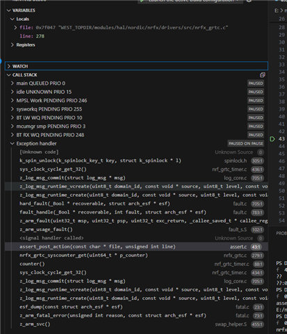

    The main program suddenly encountered assert (nrfx_grtc.c line 278)while running, which happened by chance. The following are the relevant logs
note:nrf54l15 v3.1.0
Do you have any suggestions? I have read other related posts and didn't quite understand them.
Looking forward to your reply!
  • Looks to me like it got another fault or error, tried to log it and got an assert while trying to read the current time from the grtc. This makes the stack trace a bit hard to read.
    Smells to me like a buffer overflow that wrote over some other important stuff, but thats just a wild guess.
    I agree to what has been said here. What you are seeing in this screenshot is probably not the root cause of your issue. It is most likely some kind of consequences of your actual bug.
    Also, can you try setting CONFIG_TIMESLICE_SIZE to something else than '0' (for example '20' which is the default value), I can be dangerous to set it to 0 as it can lead to some concurrency issues. I would say that it is better to play with the thread priorities or maybe semaphores if you need a thread not to be interrupted.
    It is possible because the testing equipment currently has a probability of dying, but the cause cannot be found yet. This is the best log captured so far, so I would like to see if you have any ideas.
