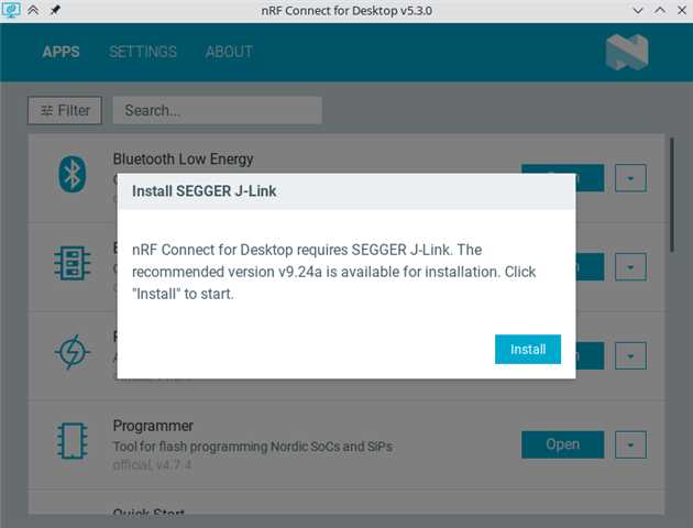

I'm using nRF Connect for Desktop on Linux and updated today to v5.3.0.
I have J-Link V9.24a installed and it is available in $PATH. Also it works well with Programmer v4.7.4, current nrfutil and all other software from Nordic.
However I am not using Debian-like distro and I get annoying message "Install SEGGER J-Link" at every startup:
nRF Connect for Desktop requires SEGGER J-Link. The recommended version v9.24a is available for installation. Click "Install" to start.
As you can see on the screenshot I can't do anything but click on "Install". This opens super user authentication window which I click "Cancel" on, then the process fails with error message in another window and only then I can use the app normally. This is a bit cumbersome way to open the application.
Ideally this process should look for J-Link in PATH and don't suggest installation if it finds correct J-Link version. Also the initial window could have close button for quick cancellation.
I think the former worked in previous version because I used to see warnings about outdated J-Link after nRF Connect for Desktop updates.
  • Hi Mateusz,
    It looks like the setup is so that /home/xxx/.local/bin/ is in the PATH when running in your shell but it is not in the PATH when running NCD. In NCD open the Developer Console Ctrl+Shift+I and there enter require('child_process').execSync('printenv PATH', {encoding: 'utf8'}) to see the PATH as NCD sees it. JLinkExe must be in that PATH for NCD to find it.

  • Indeed, variable PATH as seen in NCD console was lacking /home/xxx/.local/bin/ path. When I start NCD manually from within my shell it inherits correct paths and finds JLink:
    $ ./nrfconnect-5.3.1-x86_64_70d66f960c8f43fc859edb9967ec9d9b.AppImage
    Now I know where the main problem is. The other one is UI/UX but I have nothing more to add to this matter.
