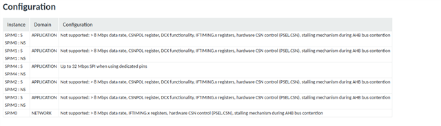

  • Im using logic analyzer. I saw that i disabled by accident a spim, after fixing that i now see SCLK MOSI generating, but still have problem with CS. If i do this SPI_DAC->PSEL.CSN = CSPIN; does than SPIM controls CS, with task start will he put pin low and after transfer put it high ?
    You need to configure CSN pin as output in the GPIO peripheral with intial value high before enabling SPIM. source:SPIM — Serial peripheral interface master with EasyDMA
    The key points here is to configure GPIO before SPIM is enabled and to set PSEL registers while SPIM is disabled. So , your approach is correct now.

  • Yes u are right but only for SPIM4 or this is wrong?
