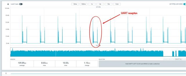

- Device cannot consume more than 1 \[mA] while waiting for a transmission - our power profiler readings suggest system ON idle consumes around 7mA.
- Device needs to maintain System-Off as often as possible to save power.

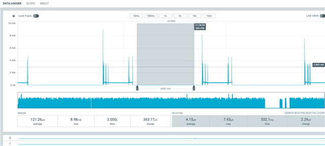

Maintaing System-On in idle
This leaves the UART and DMA fully intact and allows it to immediately capture the data burst without needed to wake the CPU.
The core issue with this solution is that the power consumption from leaving the device in system-on idle is way too high.

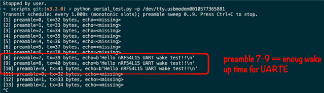

The issue we run into here is that waking from System-Off is essentially the same as rebooting the device. This means that the UART interface and any configuration for it is lost and does not exist at the moment the system starts to reboot. By the time the Zephyr kernel is loaded the data burst is already over.
System-Off with RX shorted to a GPIO (PRE-KERNEL INIT)
Building off the last solution, we placed an init function for the UART before the Kernel starts to load at the ``PRE_KERNEL_1`` entry point. This successfully initializes the UART early enough to begin capturing the data burst however it starts ~6 bytes into the transmission.
The issue with this approach is that the UART protocol does not define a way to start capturing in the middle of a data burst (transmission). If the first edge (hi->lo) the hardware sees is not the start bit of that byte, that byte will be corrupted and will either cause the following bytes to become corrupted or trigger a corrupted frame error stopping capture all together.
This essentially means that even though we managed to wake up fast enough to "see" the transmission, we have no way of reliably understanding what is actually being sent.

  • In short, there is no way to capture the first byte(s) sent from the target device if the SoC is in System off. This is because the UART is not active in this mode.
    The expected current for sleeping while waiting for UART is around 130uA, as the system must be in System on all idle with the UART RX enabled. This is the "normal", though pretty power hungry way to wait for UART data.
    System on all idle can achieve around 5uA if the UART is not enabled, the wakeup time is around 7us. System off acheives way lower, with a startup time of aroung 60us. If you are okay with loosing the first UART byte, you could either:
    If system on all idle, Deinit the UART, configure the RX pin as gpio interrupt, wait for interrupt, immediately reinit the UART.
    If System off, disable the UART, configure RX pin as GPIO wakeup, on wakeup, configure UART (should be automatic since system is rebooting)
    At 9600 baudrate, the first byte will take around (1 / 9600) * 11 = 1.1ms so the SoC has plenty of time to wake up before the second byte.
    If its imperitive that the first byte is not lost, best case is still those 130uA.
    Regarding the external UART with FIFO, that could surely work if you find a particularly low power one. But that is of course quite costly, and will use more current while active compared to using the internal UART given you now have the SoC + some bus + external UART enabled while talking to your target device.

  • The problem with this is that UART hardware can't tell the difference between a first true start bit edge (hi->lo) and just some random data bit flipping the RX line. If the UART peripheral capture triggers on a data bit pulling RX down and not the start bit, the capture frame is fundamentally corrupted and the hardware has no way to recover from that. Any data the UART pushed to the DMA (if it even manages to get a valid frame by chance) will be corrupted.
    I could be miss-understanding the inner workings of UART but from my testing this is exactly what is happening. I can wake the UART up fast enough to begin capturing part of the preamble but the received data is sometimes correct, other times completely garbage.
    Just to address the timings you mentioned, from my testing I found that POST_KERNEL takes roughly 11 [ms] to reach. This is what led to moving the initialization to PRE_KERNEL_1 which is sufficiently early to start the capture during the preamble window.
    You mentioned an interesting point about System-On where disabling the UART reduces its power draw. I think you are completely correct with that. We just did some more testing of the power draw in System-On mode and it is a lot lower than our previous results managing to maintain a idle draw in the 6 [uA] region. I will try some more tests with exactly this just to verify.
