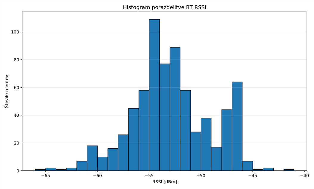

Problem:
We have a huge variability in received RSSI (see picture) despite both devices being stationary in test setup. For our use case, accurate RSSI is critical.
nRF52840 datasheet shows RSSI accuracy +/-2 dB.

    Is this a radiated measurement?
    If yes, then this is expected to vary. See other threads (search for "rssi radiated" or similar on this forum), for instance this:

  • These measurements are done on RX side.
    Please check the attached video of specral analyzer with lab-grade log-periodic RX antenna.
    Despite having the same nRF transmitter, we are unable to replicate this RX variability with our lab-grade antenna.
    So, the question remains, why do we get this RX RSSI variability? And mostly, what can we do to mitigate it?
    Can you please confirm how you are measuring the RSSI?
    If it is conducted, ie. connected via a coaxial cable, then you should see little variation.
    If radiated, ie. antenna to antenna, you will see high variation.
    Håkon
  • The spectrum analyzer is connected to RX antenna, i.e. signal goes through the air.
    TX - RX air distance is cca 30 cm in the test setup (in practice it will be meters).
    Can we do anything to minimize this RX RSSI variability of the nRF?
    It is expected that RSSI varies when measuring radiated.
    Just to avoid any confusion here:
    It is not from the nRF radio itself, it is due to reflections and other physical parameters, as listed in the initial link.
    If you connect a coaxial cable between the transmitter and receiver, and place it in a shielded box; you will get accurate measurements.
    Håkon
