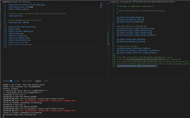

We are in the middle of an upgrade to 3.2.1, and we encounter the following issue using SB_CONFIG_MCUBOOT_MODE_SWAP_WITHOUT_SCRATCH, SB_CONFIG_MCUBOOT_MODE_SWAP_USING_MOVE & SB_CONFIG_MCUBOOT_MODE_SWAP_USING_OFFSET
Basically right after flashing `b0` fails to boot:
*** Booting nRF Connect SDK v3.2.1-d8887f6f32df ***
*** Using Zephyr OS v4.2.99-ec78104f1569 ***
Attempting to boot slot 0.
Attempting to boot from address 0x8200.
[00:00:00.000,854] <inf> bl_validation: Trying to get Firmware version
[00:00:00.001,129] <err> bl_validation: Invalid size or total_size in firmware info.
Failed to validate, permanently invalidating!
Attempting to boot slot 1.
Attempting to boot from address 0x18200.
[00:00:00.001,892] <inf> bl_validation: Trying to get Firmware version
[00:00:00.002,197] <err> bl_validation: Invalid size or total_size in firmware info.
No bootable image found. Aborting boot.
One of the main reasons we want to upgrade to 3.2.1 (qualification aside) is to get the new "OFFSET mcuboot algorithm" (SB_CONFIG_MCUBOOT_MODE_SWAP_USING_OFFSET),  since 2.9.0 does not have that we were using the MOVE algorithm ( SB_CONFIG_MCUBOOT_MODE_SWAP_USING_MOVE ), and that was working fine, until the upgrade.
Another weird thing we found is that (SB_CONFIG_MCUBOOT_MODE_OVERWRITE_ONLY) botos alright and allows us to do the updates ( but we want to move to SWAP using OFFSET)

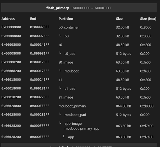

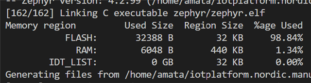

    Swap using offset requiers an additional page on the secondary slot. Can you show your full memory layout including the secondary slot?
    Also, the error message is printed from here. Perhaps you can either check with a debugger or expand the printout to see exactly which check fails, and which sizes are compared?

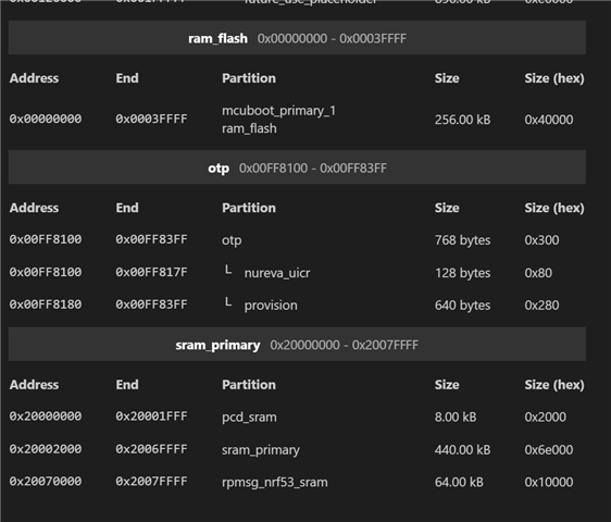

  • Hi  ,

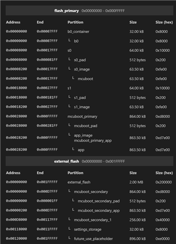

    After checking that code, I realized our PM_S0_SIZE & PM_S1_SIZE was wrong in our partition layout, so changing that let the `b0` boot correctly :) , but as you pointed out the OFFSET algorithm is still not working, we are missing something ( MOVE does now :)  ), but here is our partitioning layout:

    ( the S0/S1 size is fixed in this one )
    We could use the `future_placeholder` for OFFSET, if needed.

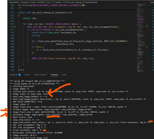

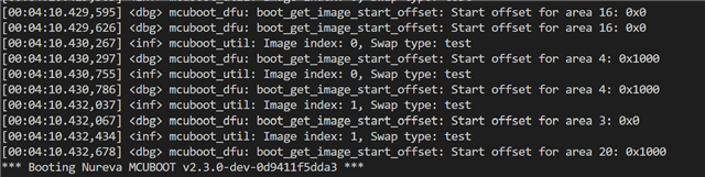

  • Well to avoid a bit of back and forth, the main issue with `OFFSET` is that basically we follow the same flow as with `MOVE`
    1. Upload the updated firmware to secondary slot
    2. Mark the secondary slot for testing ( pending: true )
    3. Reset the Module to test image
    4. OFFSET swap fails, and boots back the firmware in primary slot
    The way it fails is by deleting the secondary slot and not performing the `test`
    ( I added some extra logging on mcuboot to try to debug, my VSCode debugger never stopped in the breakpoints on mcuboot code  :( :shrug: )
    On the application side, when uploading, and marking them for test ( pending: true ), it does seem to account for the Offset initial sector used for swap
    Same configuration with same flow using `SB_CONFIG_MCUBOOT_MODE_SWAP_USING_MOVE` works fine.. as soon as we replace it with `SB_CONFIG_MCUBOOT_MODE_SWAP_USING_OFFSET` it fails.
