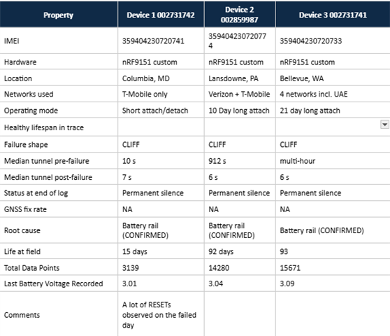

  • Hi Oyivind,
       What information does the signaling logs provide?
     This is the brief of what we observed in the field for three devices. I can provide you the complete log if you want.

  • MidhunSqt said:
    We checked it with the AT commands on the DK  (AT+CPSMS?). We are testing it in US
    Do you have access to AT commands on the devices in the signaling logs? Where is the DK located compared to the devices affected?
    Modem traces would be beneficial for us to determine if the signal quality of the field device(s) is on par.

  • Currently we only have access to DK which is located in Whiteplain NY ,US .Devices are in different location .  We can take modem traces of that only. Signaling log doesn't explicitly show anything about PSM as far as i know.
